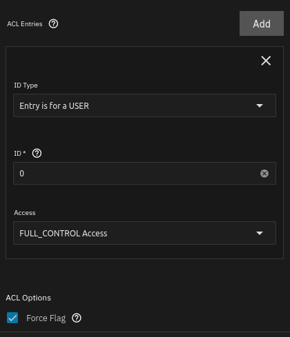

The ACL Entries for all of my Host Paths are the same. Though, it looks like /cache/transcodes is the [internal] mount path inside the container…
My experience with containers is somewhat limited, so any advice on what I am doing wrong, and how to fix it will be much appreciated.
Update: Removing the Enable ACL option, & adding user & group 568 to the relevant dataset permissions (and set to Full Control), seems to have cleared up the “Permission Denied” error in the logs. However, it is still stuck at deploying.

Is /cache/transcodes binding to another path? Does the 568 user have permissions to the path it’s binding to?
