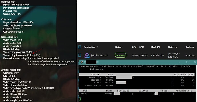

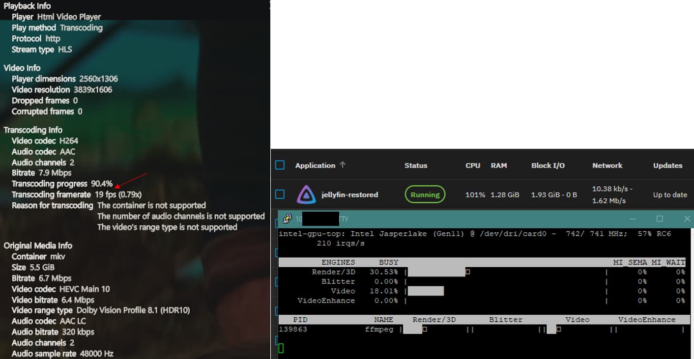

For now, I’m not entirely sure I’ve done everything correctly but I can at least demonstrate a >2x improvement in frame rate when transcoding a 4K HEVC Dolby Vision Profile 8.1 (HDR10) video with AAC 5.1 audio to a 4K H264/AAC 2.1 output in a browser. (Disclaimer: This is just a stress test. Best practice is, of course, to convert all videos into a format that will direct play on clients without relying on transcoding. I personally go for H264/AAC still to support some older clients in use, otherwise I’d go H265/AAC - but I welcome any corrections on the best codecs for a mixed ecosystem of new and old window, linux, android, and iOS clients)

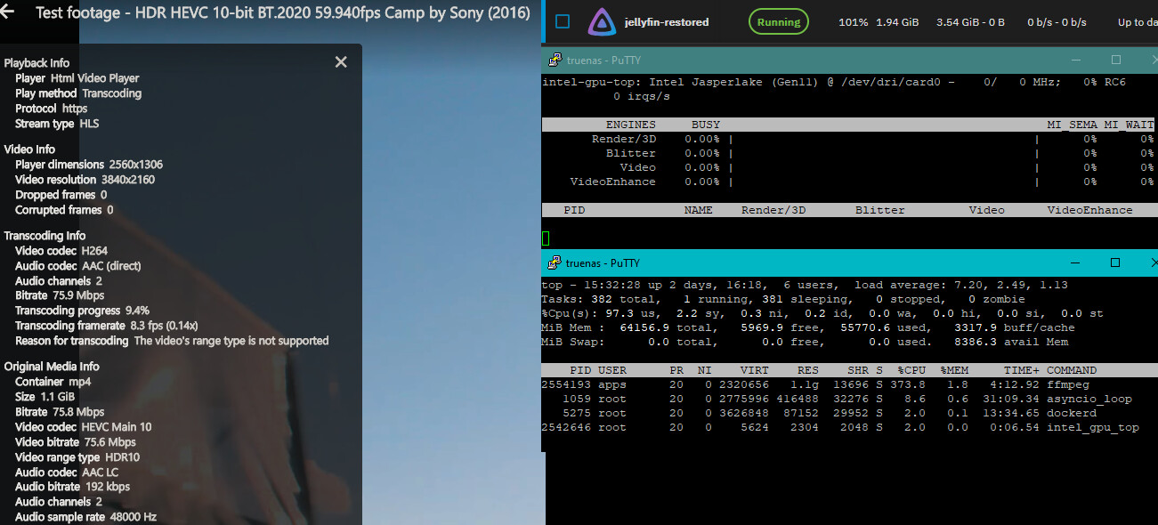

Without HW acc’l: ~9fps, CPU at 100%, iGPU at 0%.
With QSV: ~19 fps, CPU at 100%, iGPU at ~50%
I can post a guide on how to replicate this setup, but first I’m curious if this is the level of performance that others have been seeing. I was hoping for much more reliance on the otherwise unused iGPU.

I noticed in your QSV screen shot, the container’s CPU usage is 101%, just 3% lower than CPU-only using 104%. I have a feeling that it’s still doing the majority of work with the CPU and has offloaded just a bit to the GPU.

Here’s the result with QSV enabled using the reference video file.
…and it’s transcode log:
20250213 ffmpeg transcode log.txt (31.4 KB)

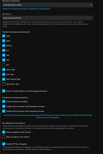

Enable hardware HEVC decoding. This should bump up your frame rate considerably, but probably won’t get you past 60fps for smooth transcoded playback.
Enable HEVC hardware encoding. Firefox doesn’t support HEVC out of the box. Support is experimental and requires a config option set. Even then, it doesn’t support 10bit or HDR video AFAIK.
Switch to Chrome or Edge to direct stream the content.
Ah, I was under the impression that Jasper Lake did not support HEVC 10-bit decoding, but it’s only the encoding that it doesn’t support. Turning that on really improved performance. Thank you for the help! I’m going to update the OP with these results and start working on the guide.

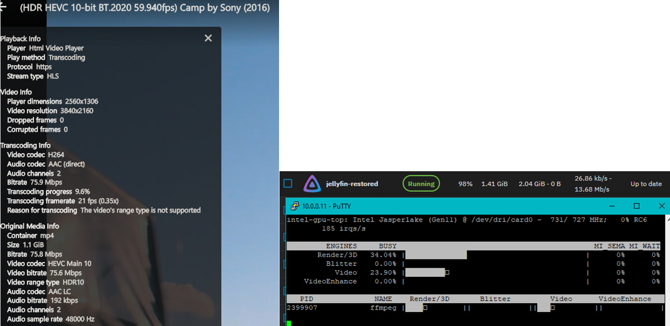

Pre test:
Updating with the test video this time:
Without hardware acceleration: CPU 100%, iGPU 0%, 8 fps
With QSV enabled CPU 26%, iGPU 100%, 57 fps

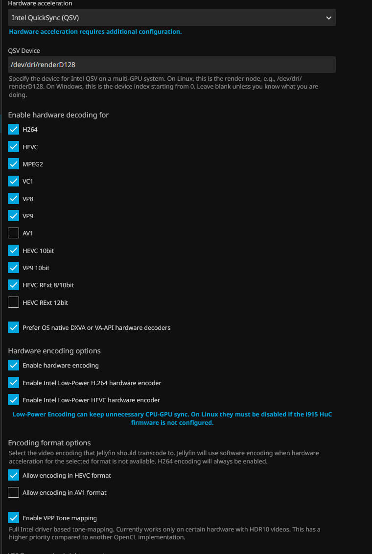

Configure Jellyfin transcoding as follows (note that I never verified these settings to be optimal, but they’ve worked well enough that I haven’t needed to mess with them)
