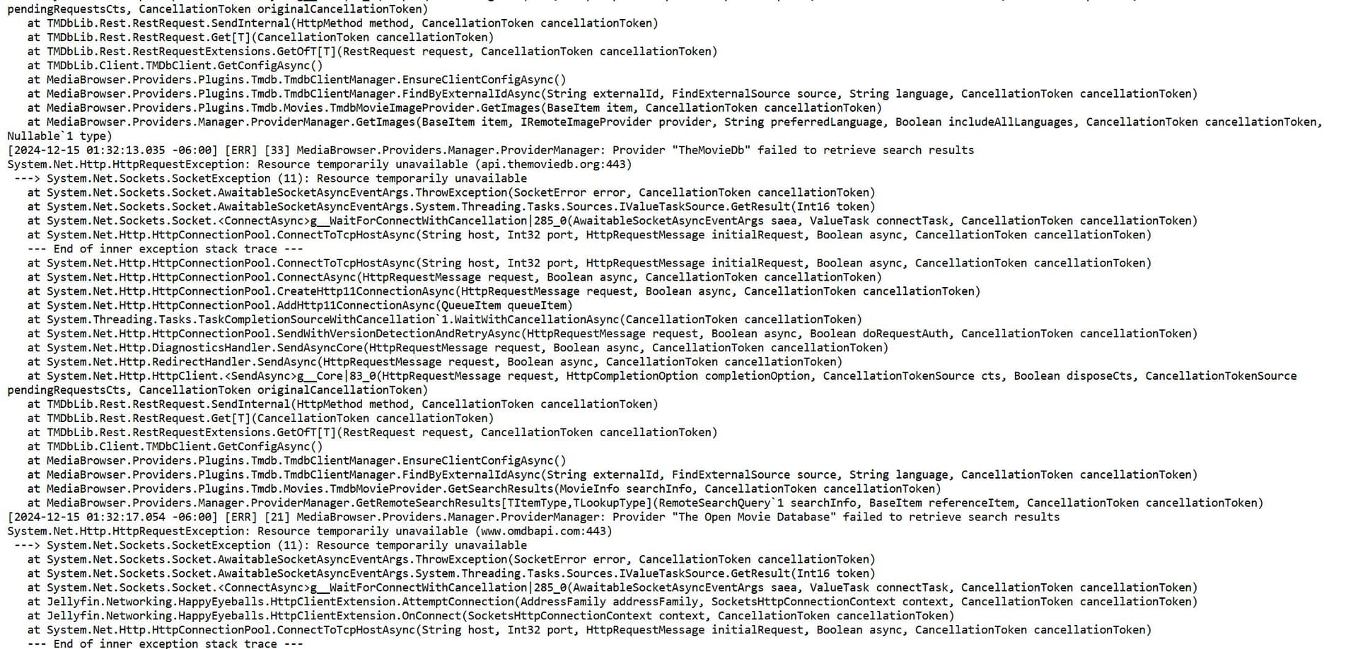

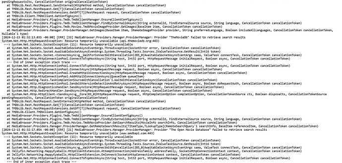

This is some of the code I am seeing when I try to search for metadata
this seems to be a network problem to me:
Provider “themoviedb” failed to retreieve search results … resource temporarily unavailable

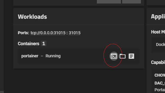

Apps → select Jellyfin → click here to enter
Screenshot 2024-12-15 094405
I clicked on it but I am not exactly sure what to type here. Again, I am newbie. This is my first time trying this part. Sorry again.

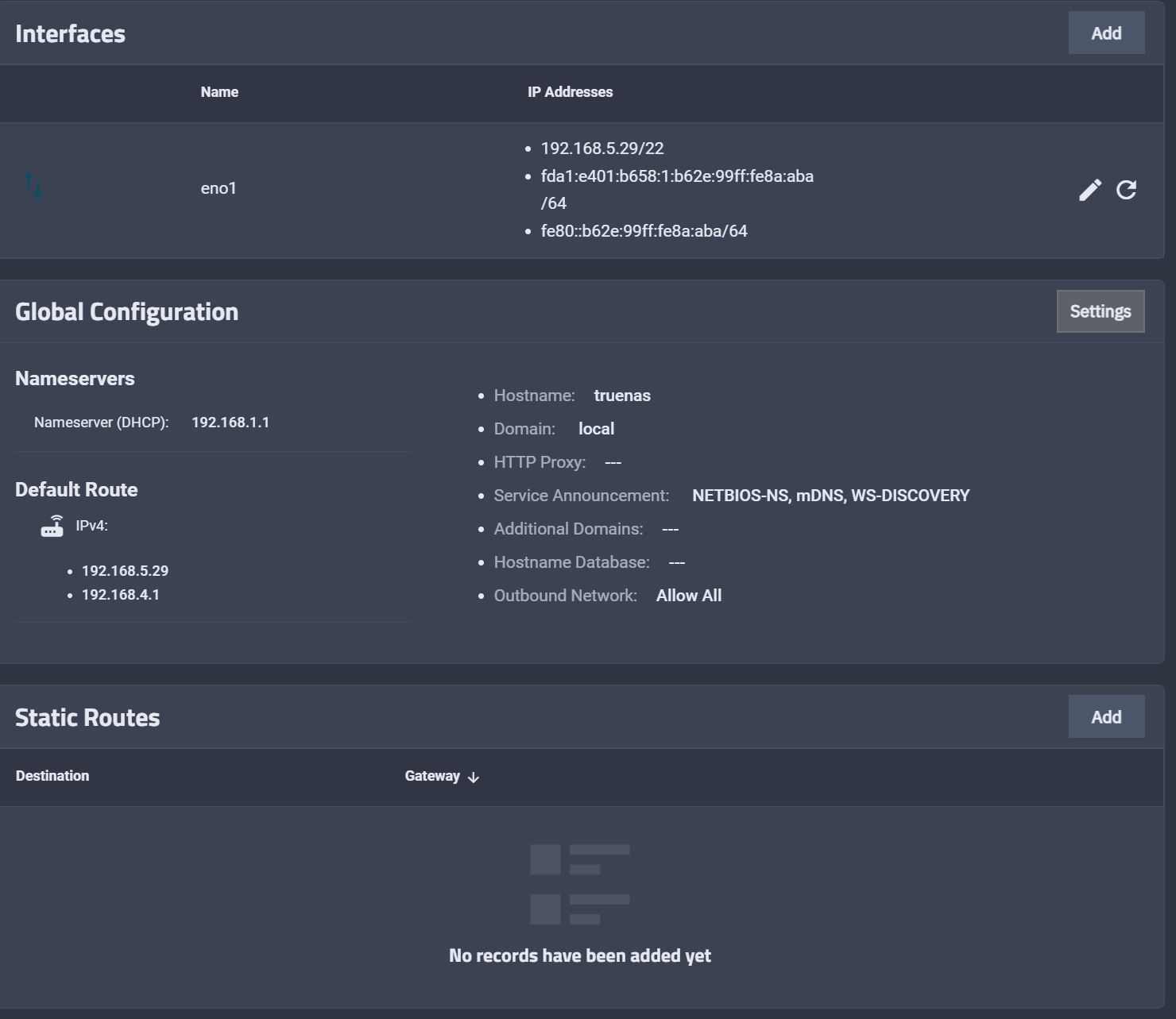

Also maybe is worth post some screenshot of your TN network config (hide sensitive data if there are).

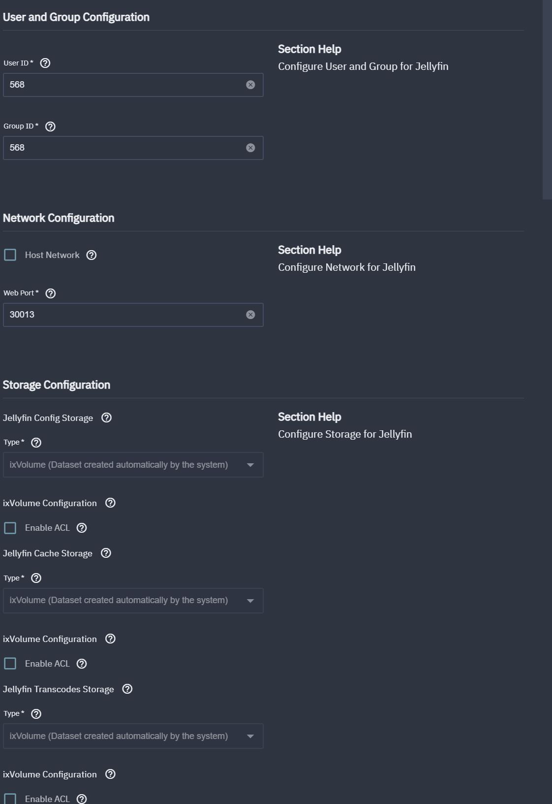

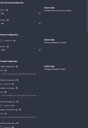

EDIT: did you install jellyfin via yaml or from catalogue? In case try to share the config of that too (not so familiar with catalogue but quite with yaml)
i downloaded Jellyfin from the apps catalogue

I don’t see anything particulary strange in your configuration, but give a look into those settings (kinda different from mine):
into Global configuration, remove the 192.168.5.29 from default gateway, don’t think is correct (i think this is the IP of your TN, right?), leave just one entry with the ip of your gateway/router, i see a 192.168.4.1 but on nameserver you have 192.168.1.1, one of those 2 probably wrong
Oh my god. That is what fixed it. Thank you so much oxyde.
