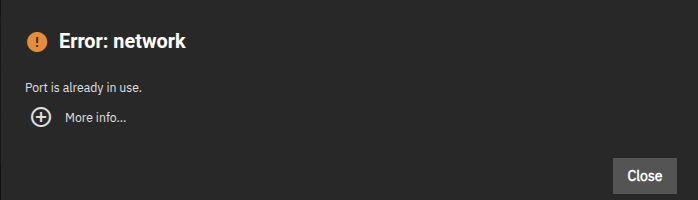

Today I was advised by TN that my apps could all be updated: all OK except jellyfin which keeps insisting “the port is in use” so I changed the port (30013) to a new one (3004) and tried again. I get the same message. I’ve tried stopping and starting JF but that didn’t change things. Then I ran out of ideas and decided I ought to ask for help please!
Jellyfin is installed as an ix-app and it uses ix volumes for config cache and transcode. The current version is 10.10.7_1.1.24 and I was trying to upgrade to 10.10.7_1.2.0
Frigate (port 30059), dockge (31014), uptime-kuma (31050) and Tailscale (n/a) upgraded OK though.
Here’s the fault log which appears when I try to update Jellyfin:

middlewared.service_exception.ValidationErrors: [EINVAL] app_create.network.https_p
What other info should I try to provide please, and what should I do to fix this problem, which I haven’t seen before (i.e. not on EE or DF or Cobia or Bluefin).
Thanks in advance for guidance!
I see that all of my apps were again marked as upgradable at some point during today but still no luck for Jellyfin:
dockge 1.2.0 to 1.2.2 OK
frigate 1.2.0 to 1.2.3 OK
tailscale 1.3.0 to 1.3.1 OK
uptime-kuma 1.1.0 to 1.1.2 OK
jellyfin 1.1.24 to 1.2.3 port is already in use

middlewared.service_exception.ValidationErrors: [EINVAL] app_create.network.https_port.port_number: Port is already in use.
In order to help me fault find this problem, is there any additional information I can provide please?

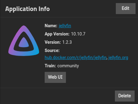

Hi. I think I faced the same issue.
I fixed it by re-deploying the app:
  • take notes of the current configuration
  • delete the app WITHOUT deleting neither the volumes nor the image
  • redeploy the app, using the same configuration and pointing it to the same custom volume/mounts
  • upgrade the app
You may also want to backup the configuration files manually, if you used ix volumes, backup the contents of /mnt/.ix-apps/app_mounts/jellyfin/
HTH.
Ahh - good advice! Let me try it - thank you!
edit, a few minutes later:
Success; I am now running v1.2.3 by following your guide. Thanks very much!
