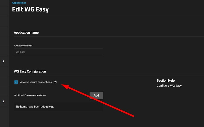

This allowed me to login after the update:
OK, that fixed the first problem, now I can login at least. However it seems my imported config doesn’t work. If I connect to it from my client, it seems to work on the client end, but I can’t reach anything on the inside, and if I run ‘wg show’ in the container, I don’t see my peer. If I revert back to the old container, everything works as expected. Is there anything special I need to do to get the new config to import and work successfully other than importing it initial setup?

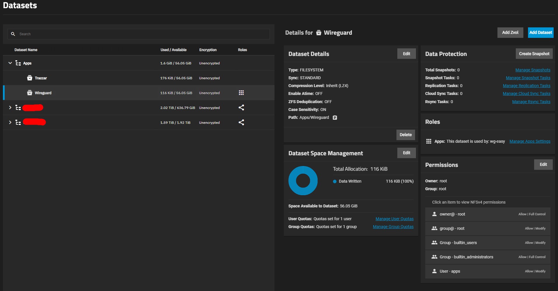

Last year, I migrated from Core to Scale and installed WG Easy.
Since then, I never removed WG Easy or changed its files in the iX directory (yes, I was using the default hidden directory).
Now, on ElectricEel-24.10.2.2 had overcome the same problem you had.

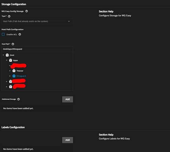

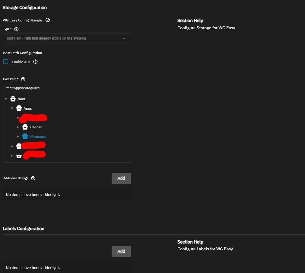

The only thing I’ve changed when reinstalling the app was to set permanent storage as shown in the image attached. Keep in mind that the dataset I’ve named “Apps” and its child dataset “Wireguard” are both of the type “Apps”. The user “Apps” is the default one.
