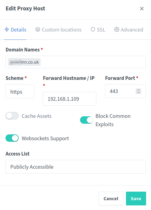

So i have been trying to learn NPM.

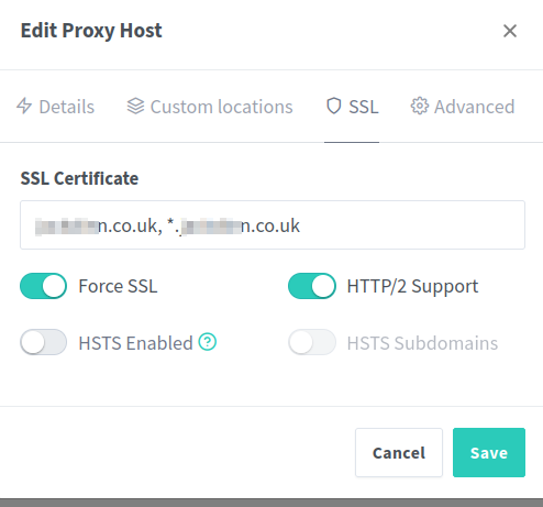

I have got it mostly working, even got https certs.
I have several app working on subdomains as a test but i just cant figure how to access my old nextcloud instance
It was built with the auto installation script by @dan (im fairly sure).
If i point my router directly to the ip:port of the nextcloud instance it works fine as it has been for ages.
But if i set the router to point to NPM and i have a proxy host in NPM pointing to the nextcloud IP im getting Bad gateway Error code 502

I followed Nginx Proxy Manager | Dan's Wiki and as i say i got a handful of apps working through NPM with HTTPS, some on truenas core and some on a separate server truenas scale, but i can not do it for the old nextcloud :frowning:
I eventual will swap to scale but im still testing and tinkering so i need to be able to switch nextcloud back and forth between NPM and direct forward from router, for now.

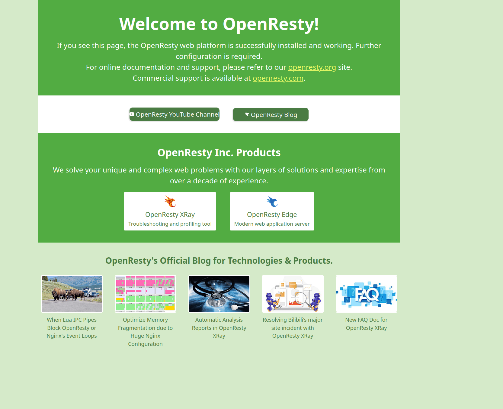

what the absolute, i just refreshed my domain and i am presented with this ??? it on my https domain??
O crap,
I switched back to router pointing to my nextcloud server directly and shut down the whole Nginx server.
What is this ??
Pheww, i though for a minute i been had but turned out it was due to the setting change that you suggested

Putting this into that advanced setting tab caused it, because when i changed them back again it was gone and we are back to bad gateway 502
I don’t know how but i think we are in the clear. I suspect it part of NPM is some weird situation they try to upsell something, i dunno but thx for the serious shock ^^

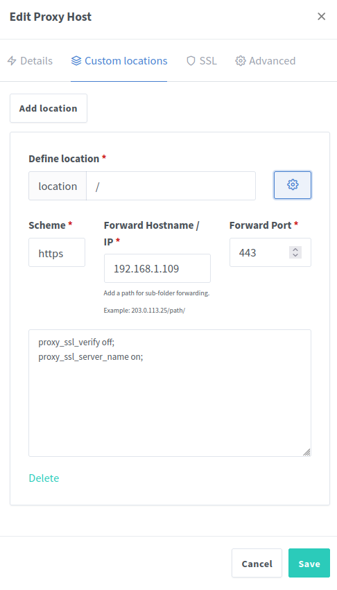

Sorry about that. I misunderstood the way NPM does things behind the scenes.
So, I installed NPM (originally, I had been using an Nginx docker host with manual config, etc), and managed to get it working with some trial and error. After installation, I inspected the .conf files it generated and learned what should, and should not be.
Hopefully this works for you:

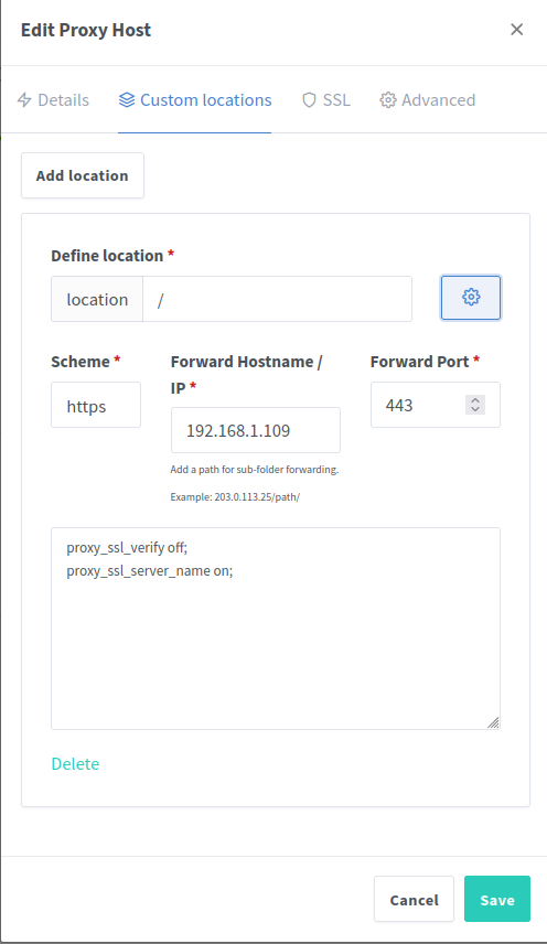

  1. empty out that Custom Nginx Configuration. This doesn’t put anything in the right place for it to work
  2. go to the Custom Locations tab and Add Location.
  • The location will be: /
  • The Scheme, Forward Host, Forward Port will match what you put on the Details tab
  1. click the gear icon (to the right of location) and add
    proxy_ssl_verify off;
    proxy_ssl_server_name on;
That seems to be the approved way to add/override configuration specific to the location block. I believe the reason for failure on my previous advice is because Nginx doesn’t like duplicate blocks; which was what I had you add.
Unfortunately no dif

Problem Recap
The issue revolved around TLS handshake errors and proxy misconfiguration:
TLS handshake errors due to mismatched configurations between Nginx Proxy Manager (NPM) and the Caddy server hosting Nextcloud.
Proxy settings in NPM weren't aligned with Caddy's certificate or its handling of local IP (192.168.1.109).
What Resolved the Issue
The actual resolution came from:
Adding the local IP (192.168.1.109) to the Caddyfile block for the tls configuration. This ensured that Caddy could correctly serve a certificate even when accessed by IP, which was previously unconfigured:
bob.co.uk, localhost, 192.168.1.109 {
Ensuring NPM's upstream settings were correct:
    Proxying to https://192.168.1.109:443 rather than relying on incorrect scheme assumptions.
    Configuring proxy_ssl_verify off to bypass certificate verification when using a self-signed certificate.
Debugging and ensuring the Caddy TLS setup was aligned with what NPM expected for SSL communication.
Summary of Fix
The root cause was a mismatch in TLS expectations and an incomplete Caddy configuration for the local IP. The fix involved:
Adding the IP to Caddy’s domain list.
Correctly configuring NPM to proxy HTTPS requests to the Nextcloud server.
Ensuring certificates in use matched what the servers expected.
If this is incorrect or misses a detail, feel free to clarify!
Nice!
Based on your log entry, I suspected that could’ve been the issue. I don’t know Caddy, so I wouldn’t have known how to advise on that.
I was going to suggest trying in your custom location config on NPM
   proxy_ssl_name bob.co.uk;
By default Nginx proxy sends whatever you specified in the hostname field, which in this case was an IP address that Caddy didn’t know what to do with. If Caddy understands Server Name Introspection, it would handle the request based on the domain name given that extra config entry (proxy_ssl_name).
Glad you got it all sorted.

I have tried putting these headers in all sorts of places but they just do not get past to caddy
proxy_set_header X-Real-IP $remote_addr;
proxy_set_header X-Forwarded-For $proxy_add_x_forwarded_for;
proxy_set_header X-Forwarded-Proto $scheme;
proxy_set_header Host $host;
iv put them in the custom locations, iv tried them just pasted as the list above and also in the way you suggested
location / {
here
iv pasted both just a list and behind the / location in here
