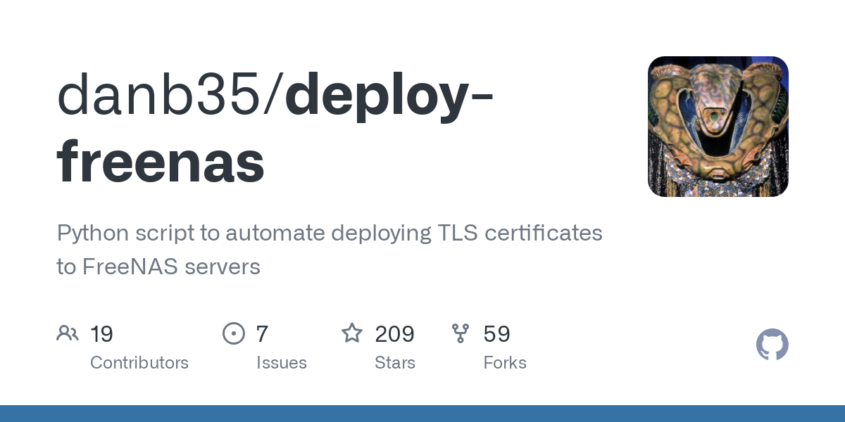

This is the deploy-freenas script used above:
I wholeheartedly support using the deploy scripts that @dan developed from inside a jail on TrueNAS or FreeNAS.
Whatever goes wrong inside the jail is limited to the jail. Worst case, nuke the jail from orbit and start over. Muck around in the root boot pool and you may be in serious trouble.

I can’t speak to OPNsense in this regard, but in TrueNAS it isn’t, and I already gave the link to the script that enables it. You’re right that TrueNAS is capable of handling the renewal itself–if you’re using Cloudflare or Route53 for your DNS–but its API is quite capable of handling deploying an external cert.
Thats against TrueNAS philosophy
I also hacked TrueNAS like enabled ksmbd, installed NIX and so on. But they don’t like it here.
Nonsense. Using the API to deploy a cert (which is what the script does) is exactly in line with TrueNAS philosophy. It isn’t “hacking” TrueNAS in any way.

The script you recommended is a complete non-sense. Not only its spaghetti python code but also its hiding bugs by doing :requests.packages.urllib3.disable_warnings(category=InsecureRequestWarning)
Be that as it may, your claim that it’s “against TrueNAS philosophy” remains demonstrably (and demonstratedly) false. I make no claim as to its being truly Python-esque, but it works, and it’s entirely in line with TrueNAS’ philosophy.
Fair point yes. I forgot that you can upload it via REST API.
Correct. It worked wonders in terms of giving TrueNAS users a level of DNS/SSL provider independence that iXsystems, for whatever reason, denied its user base for a couple of years in TrueNAS GUI-land.
As of 24.10, OVH, Route 53 and Cloudflare are the only choices within the TrueNAS GUI universe. Under 13.3 it was only Route 53, IIRC.
@dan developed a script that worked for TrueNAS. Its popularity likely helped focus iXsystems on making more DNS authenticators available via the GUI. Credit where credit should come due.
If someone doesn’t like the underlying python code, instead of complaining about it, an improvement suggestion could have been filed. Or the code could have been forked. Etc.
I’m grateful that I was able to secure my NAS GUI followed by using his other scripts to also secure my network infrastructure. Thank you, @dan.
…or I’ve happily accepted PRs against my code. It’s very hack-y at best, and I’d gladly accept improvements from those who know Python better than I (which would be lots of people).

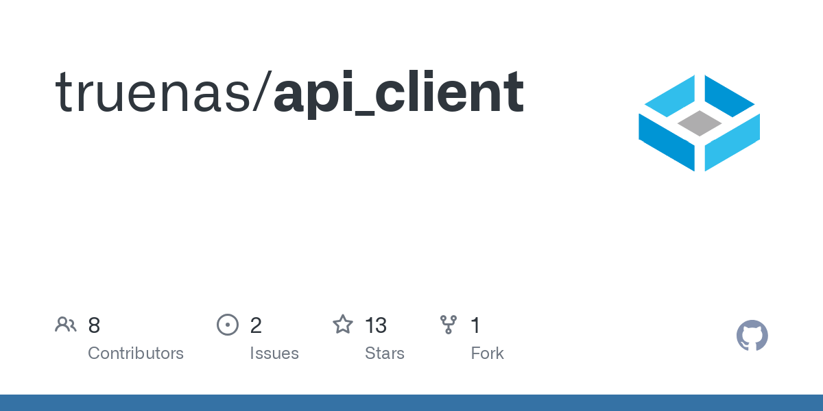

It’s probably time for a rewrite in any event; I understand the REST API will be going away in favor of a Websockets design. At some point, the script should probably use this instead:
I don’t know if I’m going to be the person to make that change, though.
