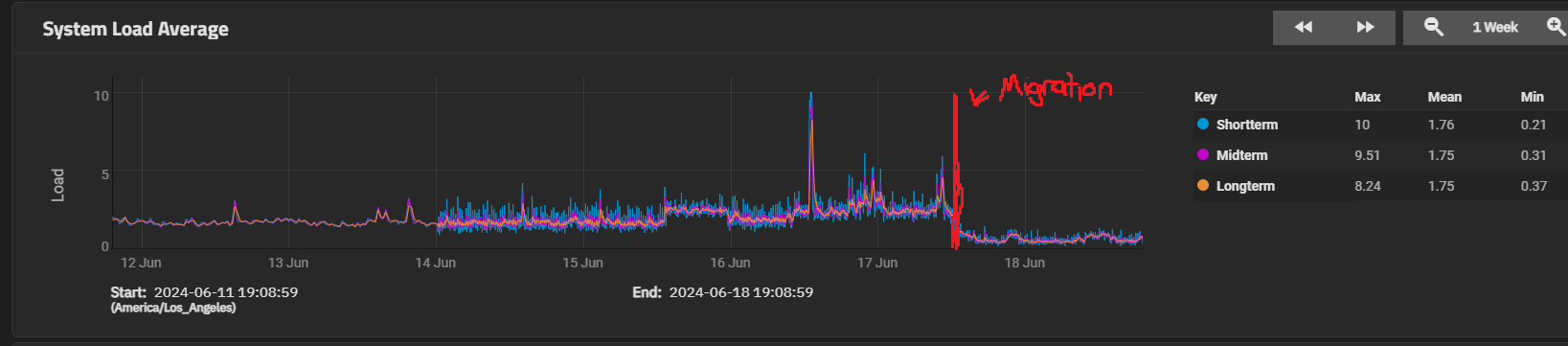

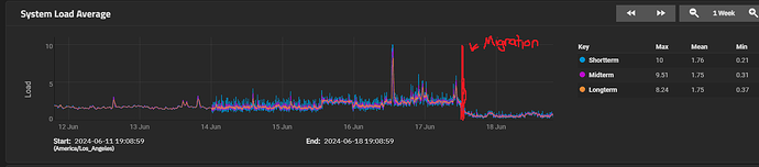

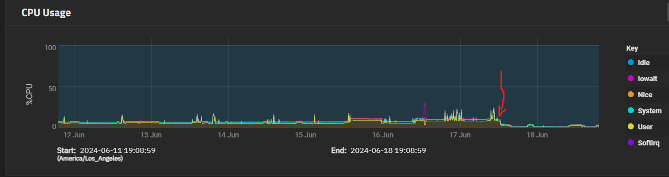

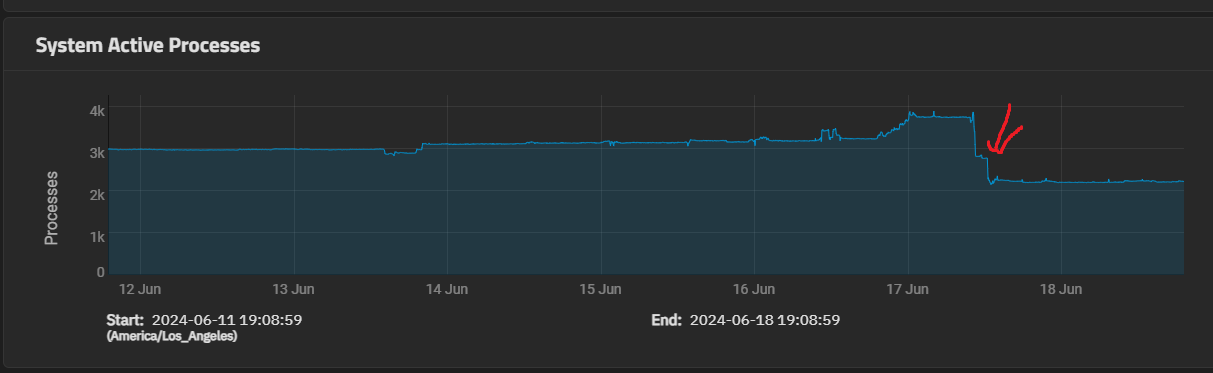

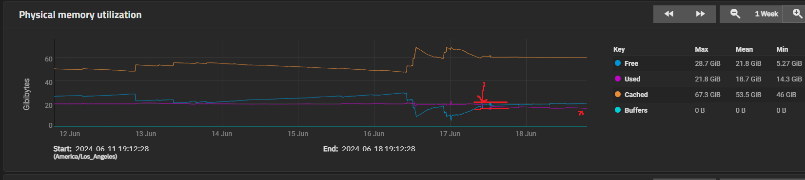

Just finished migrating over from TrueCharts to sandboxes using jlmkr, dockge, and docker compose; and wow! Everything is so much better!
Traefik and Authelia took a bit to get all setup; given that was the most “abstracted away” elements, and my immich database took some effort to get restored to the new database instance, but in all, it took only about 8 hours and I got all 28 of my apps migrated over and they’re all running perfectly now in my sandbox.
Since I didn’t see anyone showing any metrics from TrueNas itself showing the CPU/RAM drop after migrating, I thought I’d throw in some images here!
Extremely happy to be able to own my own destiny with respect to application updates, have easy access to all of the great docker compose scripts, and see a nice drop in resource overhead.
Thanks so much @Stux for the video guide! I started my migration by watching your youtube video. It was an incredible starting point (and the bridge network setup video as well!). Really looking forward to watching the snapshots one if you get around to making it; that’s the only thing I don’t have in parity yet (the nightly backups of config diffs with 1 week retention, and nightly pg dumps); that’d be nice to have, and perhaps I can figure it out myself (all the data is just in normal old datasets, so it’s likely there’s a truenas solution here also).
Anyway, thanks again, and really looking forward to having this feature improved and potentially made more of a first-party member in future releases.
