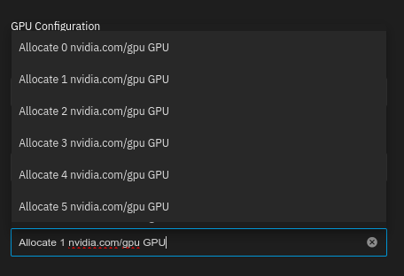

I have another question, this time around the GPU passthrough option. In Truenas’s Apps, I can allocate my Nvidia GPU to multiple apps. Is this possible with jailmaker? I’m thinking in line of wanting to run Plex and Jellyfin and passthrough to both as an example.

Just seeing if anyone has an answer for this. Thanks.
Multiple jails can use the GPU simultaneously.
Sweet, thanks for confirming!
