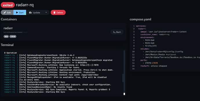

So I run 2 instances of Radarr, the first is on standard port 7878, so I want to access the second Radarr on 17878, I changed the port to 17878 in compose.yaml but on the Terminal it is still listening on 7878. If switching to bridge modes fixes that I will move to that otherwise I will do more research on dockers. With Charts I just assigned the app a different port and it worked fine.

Normally you specify a portmap ie hostport:containerport
So 17878:7878
Assuming 7878 is the default port and what the container listens to internally, which is also what the log logs.
This means the outside world speaks to the container on 17878 and docker remaps it to 7878 on its way into the container

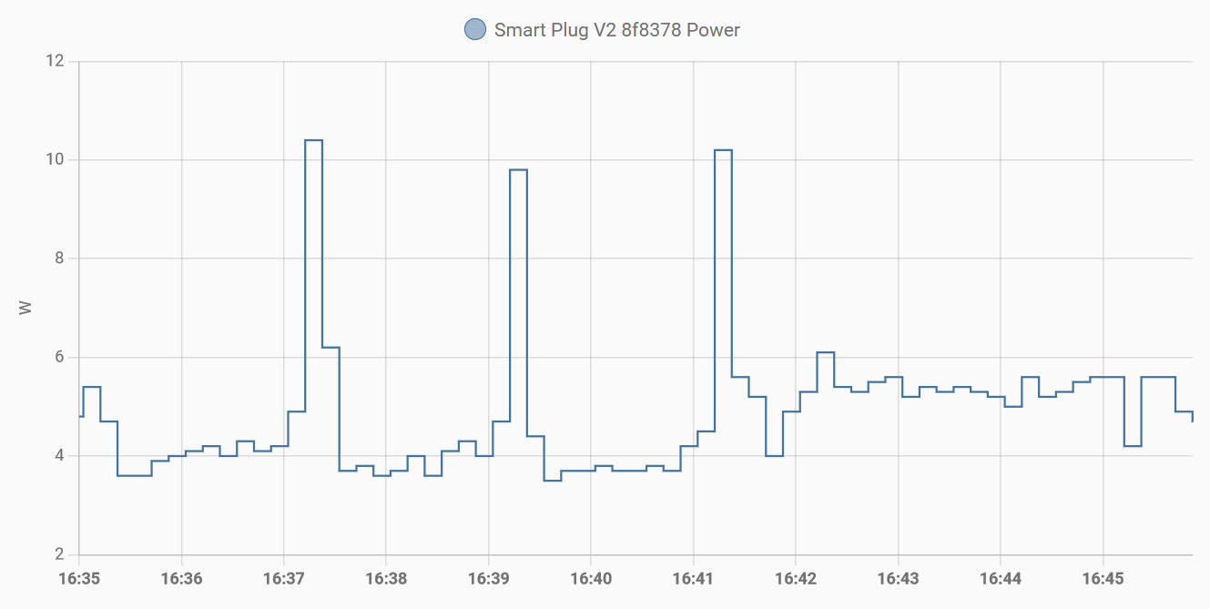

Running a new clean TrueNAS Scale 24.04.0 installation on a i3-10100T system (HP ProDesk 400 G6) uses about 4.4W Average in Idle… bestcase would be 3.5W!
Just setting up App Pool and installing Jellyfin (from 15:15 to 15:20) increases the idle usage to AVG 6.6W
Shutting down jellyfin App (15:26) does NOT help, simply having Kubernetes Running uses energy!
Only unsetting App Pool (15:31) gets the energy usage back to normal.
Using Jailmaker with Docker, installing Portainer and then Jellyfin uses AVG 4.8W
But as you can see there are some higher peaks.
I didn’t measure explicit the same on my AM4 Ryzen 5600 System… but even there Kubernetes increases the Powerdraw by a LOT!
