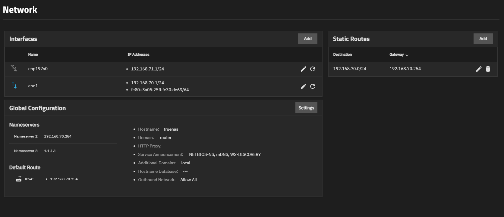

So I was trying to connect the 2.5g LAN port (2) to my PC and the 10g LAN port (1) to my main router / LAN.
I tried bridge of the two ports that worked however was slow (speedtest down from 600 mbps to 300 mpbs)
My main lan is 192.168.70.0/24 with my router 192.168.70.254
So I set a static IP on 2nd LAN port in TrueNAS to 192.168.71.1 and my PC to 192.168.71.2. With a static route as below
I can login to TreNAS on 192.168.70.1 but cannot see the rest of the LAN from my PC & no internet access.
Any advice much appreciated.
Thank you Peter

The static route is unnecessary; 70.254 is already your default gateway.
How would you expect to? It’s a NAS, not a router. There’s nothing in it that’s going to forward packets between 192.168.70.0/24 and 192.168.71.0/24.
Best course of action is to go back to using the switch, or perhaps another, better one (this one draws only 18W max, and is fully managed).
Failing that, connect the PC to the LAN and to the NAS, and access the NAS using the 71.1 address.
