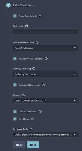

Regarding the certificate creation I know I had selected HTTPS RSA Certificate.

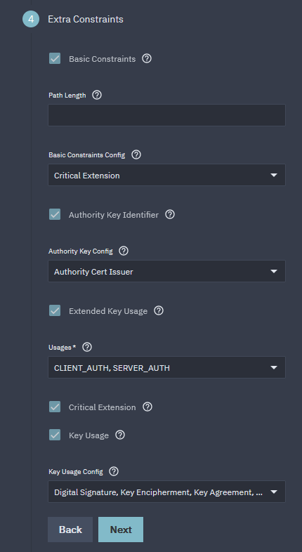

For the 4th step, ‘Extra constraints’, I have the following :
Does that look right ? I think it’s defaults, but not sure now, that’s a lot of options I don’t understand fully.
Either RSA or ECC should work, but ECC is teh new hawtness.
On the key usage config, you have some options selected that aren’t selected by default for me–the only ones I have selected are Digital Signature and Critical Extension. And a CRL with only those checked results in a cert that works.
