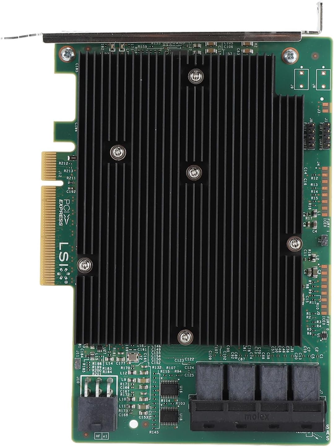

I am wondering if this would be a good choice for an HBA?
I am in Canada, so my choices are more limited due to shipping/custom costs/issues.
I can’t say if this is a good choice or not, but someone will chime in. My first thought was, did you read the specs? Manufacturer name, etc? Notice a problem? This appears to be a fly-by-the-night seller that is forced to stop selling onder a previous name and created a random name to bypass the restriction. This reseller will likely be shut down again in a few weeks or so. To me, this is a HUGE red flag. My advice, do not buy this. Probably counterfeit.
Someone else should be able to tell you if a “genuine” version of this card would be suitable.
I do have a question… What are you replacing? Or is this just an add-on? And why the “upgrade”? What more do you expect to obtain?
9300 is two 8i chips glued together so often it runs very hot. You either need to put a cooling fan on top of radiator or try to get more modern designs like 9305 or 9400
Lots available in eBay in China and being in Canada is totally irrelevant.
Regardless of whether the HBA is good or not, you absolutely need to confirm that your WD Red drives are NOT SMR drives (which are absolutely unsuitable for ZFS redundant storage due to bulk write performance limitations).

I am using an old i7-3770 machine with an SAS2008. I am swapping it out for an i7-8700 which is a PCIe Gen 3 bus, so I though that if it doesn’t cost too much that I would go for a Gen 3 capable HBA. The reason for the extra ports is that the old mobo has 8 SATA ports, and the new one only has 4, and I need a spare port for my removable backup drive.
Thanks I’ll take a look at hose and see if I can find something that fits budget. I don’t want anythiing that requires active colling because of the noise.
Absolutely a valid reason. I just wanted to make sure you were not doing it to gain more speed, which could be the wrong decision depending on how you plan to use the device in the future.

Unfortunately this is not possible even with 9400 16i board. Those LSI controllers just love to run hot like there is no tomorrow.

My advice to you is, unless you are really gaining something that you need or just really want, the addition of the new HBA will only draw more power, generate more heat, and you will need to ensure proper cooling (keeping in mind that these things are really designed for a High Airflow Case. Keep it simple if you can and you will be better off.

Yes, helps a lot… I think if I can get away with it I will just keep my current HBA and just upgrade the CPU/Memory for running containers which is something I have wanted to do for a few years, but wasn’t easy for me to do with CORE.

Then, do NOT use a HBA…

I’ve been running on passively cooled SAS2008 HBA for about 10 years and it hasn’t had any heat problems.
