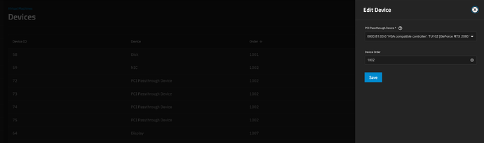

The only (and the best) way to do that would be to pass the whole HBA to the guest using PCI-E Passthru. This does unfortunately mean you’d be unable to use the other ports in the HBA for other things on the host. The PCI-E device will potentially have multiple sub devices, you need to pass each through to the VM. You can see here that the video card actually has a total of 4.
81:00:0 - 81:00:3 in this example.
But its all one addon card.
Load order shouldn’t matter in most situations. Just pick something 1002 or higher.
Example of a GPU device passed through for Plex
VM is “The Way” imo
