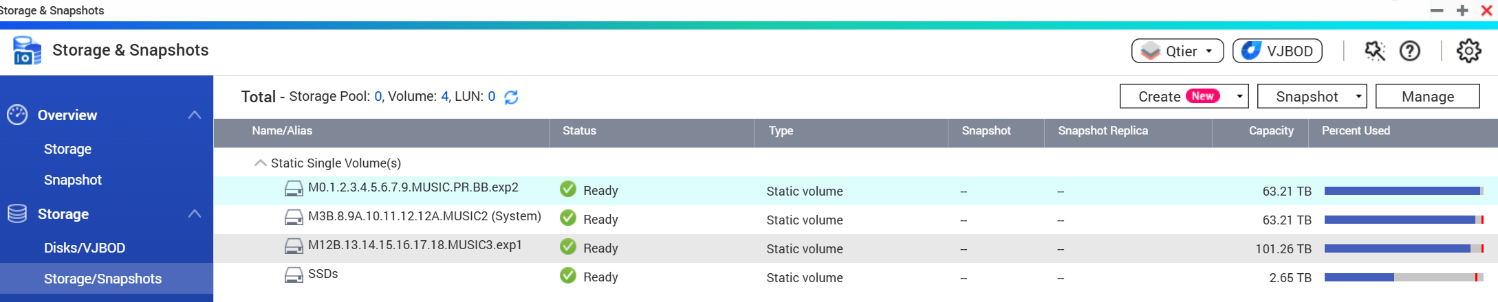

This part troubles me, a little, in that the ~20% unused becomes its own parity in a way. And again, in my previous QNAP RAID5 life with 8-12 drive pools, it seems mighty happy w/ 80+% usage.
Here I have QNAP storage pools at 92-98% use levels. They have been this way for years. Perform exactly as they did on day one.

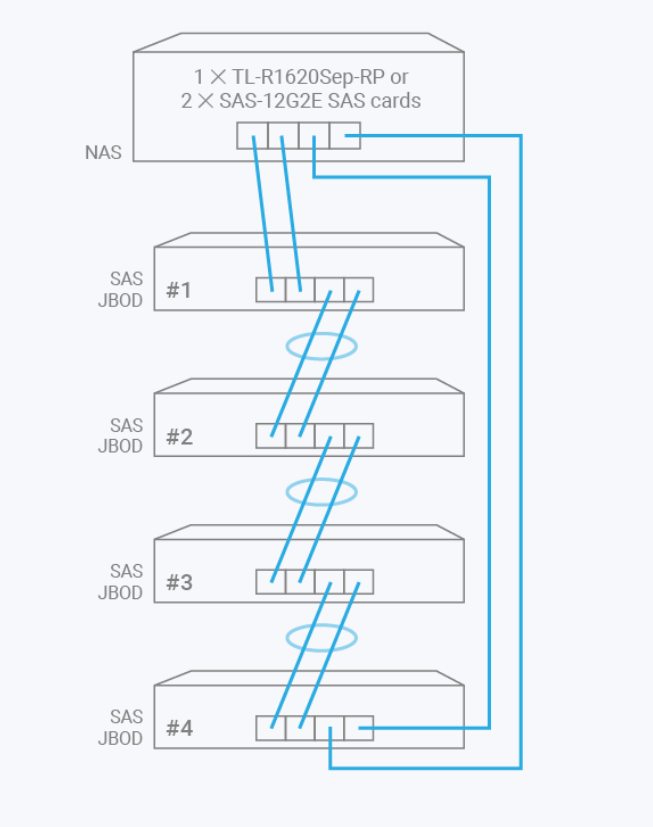

Do you know you can rely on SAS expanders instead?

Yes, I will certainly be using a SAS expander for my JBOD builds, if I want to make my own JBODs (still debating). But I didn’t want to add them ad infinitum on a single external HBA port. I wanted to ideally have no more than 2 JBOD chassis (at 12 drives per chassis) per external port. And I even wanted to try and see the benefit of the “performance connection” on an Areca ARC-4038 whereby I use two sff-8644 cables out from my HBA to the ARC, and two sff cables out from the ARC to another ARC (multipath routing, link aggregation, etc.), and then back to the HBA…

TrueNAS does not support Multi-Pathing. I had my external SAS expander MPT and ran into issues with duplicate devices. A very bad situation. I was able to power down, remove the second path, power back up and all was OK.
Chris and Kris do a good job explaining why MPT was dropped in the T3 podcast here: https://www.youtube.com/watch?v=O0SsoFB9VUE&t=821s (and yes, I am the one who asked that question).
what about link aggregation?
I think it’s looking more likely I will build my own JBOD with a standard SAS expander card!
