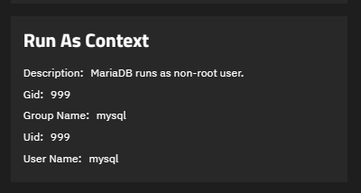

I haven’t installed Mariadb, but based on this:
I’d suggest

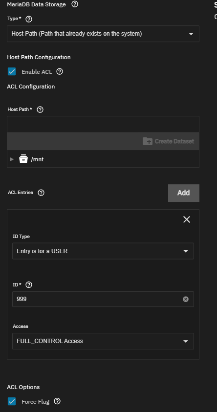

Adding an ACL Entry for UID/GID 999 like this:
Take a look at “Configuring Host Path ACL Entries” here: Managing Apps | TrueNAS Documentation Hub
In order to redefine storage I had to tear it all down and start over. Bound IP alias, set acl on host dataset, and bang! One more barrier to my Core migration smashed. Thanks for making it easy. Also confused as to why this is the first time I ever ran into this issue…kinda wish something would have nudged me this direction.
