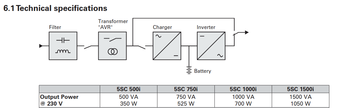

Ah sorry, your server is probably permamently drawing power over that Eaton 5SC 500i (350W/500VA). In this case boot phase is relevant for this Line-Interactive UPS since power always runs over Transformer “AVR”:
