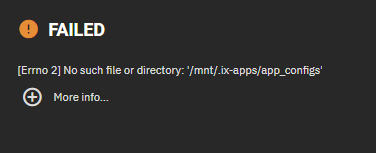

well. just want to update here. seems like my replication has failed. and unable to open apps from the new pool. luckily no data loss.
moving forward. perhaps i should replicate it to another truenas scale. at least my prod is not at risk and not compromised…
we can close this thread as for now. :sweat_smile:
