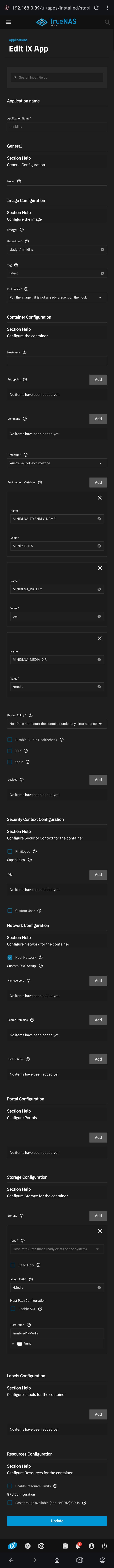

My music is on scale and I want to connect it to denon x1800h avr. I install minidlna (custom app, because it’s not in scale ) i can connect to it but can’t see any of my music.
This is my settings for minidlna. Any help is welcome.

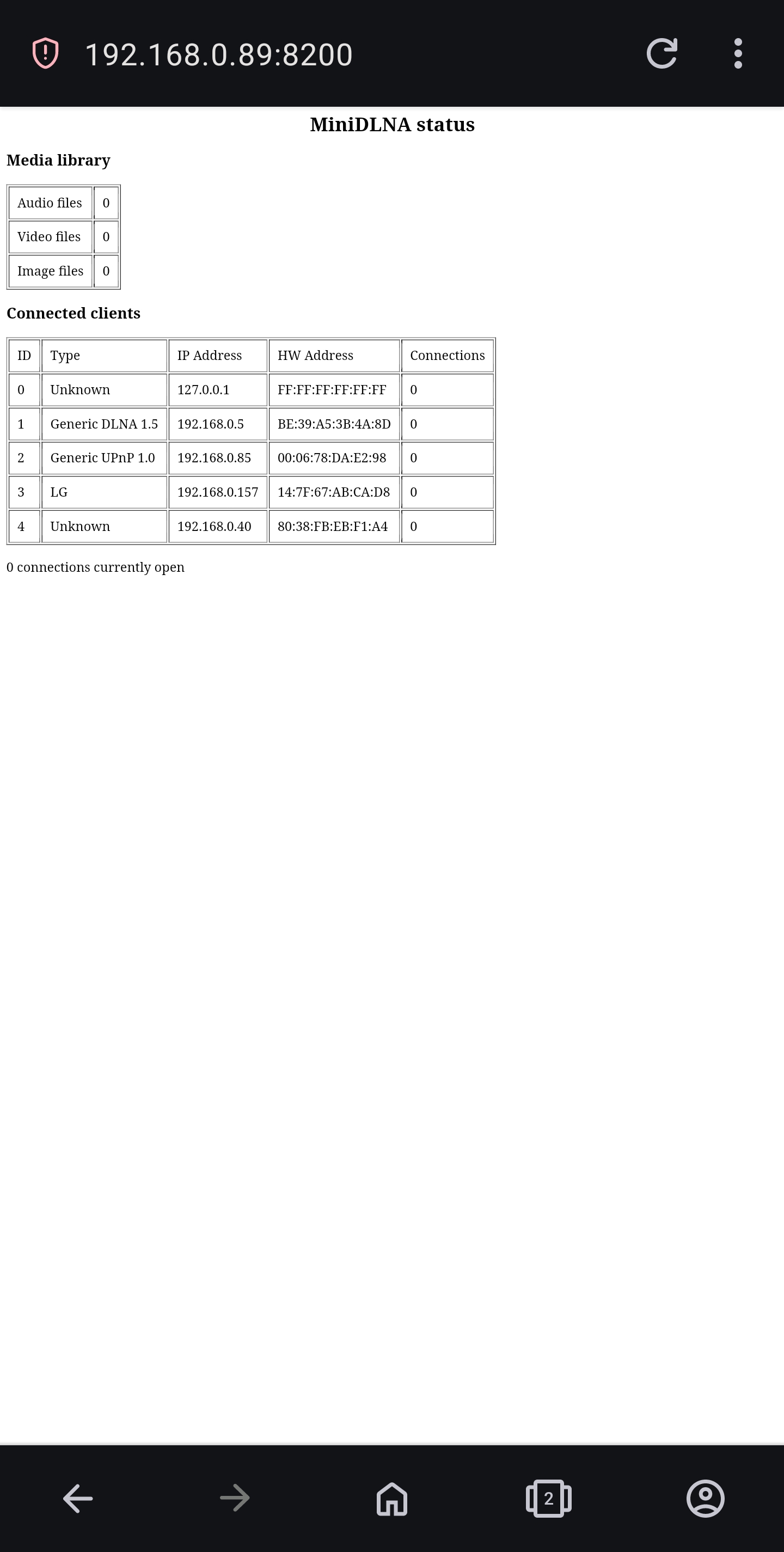

Have you tried to connect to the default web interface http://yourIPAddress:8200 to see what comes up?
Generally this type of problem occurs because you didn’t link your /media directory in your MiniDLNA to your physical location.

This is what I get on my ip
Yes, no data is being shared with the App. I would help more but I have not used that App, in fact I don’t use any apps. But have you read the user guide for TrueNAS Apps? I thought it told you how to setup the mounts. Give it a look.
