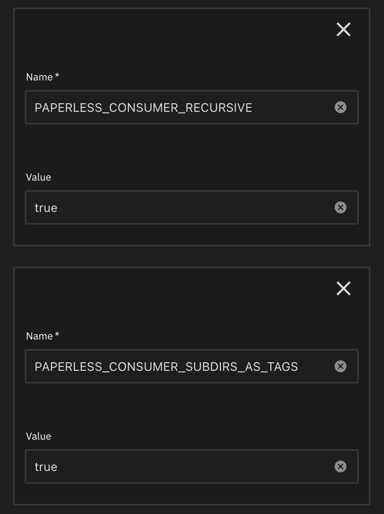

Thanks, this worked for me and after I added the environment variables PAPERLESS_CONSUMER_RECURSIVE=true and PAPERLESS_CONSUMER_SUBDIRS_AS_TAGS=true
That allow paperless-ngx consume any folder containing documents when is placed inside the consumption directory on the mounted path beyound /usr/src/paperless/consume
