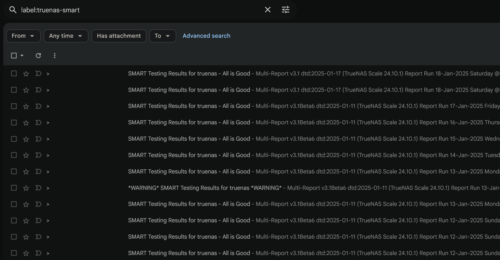

Followed by my receiving an email which says (snipped screenshot):
along with ten attachments (config tar, an old multireportconfig.txt, a multireportconfig.txt, a statsmartdata csv and six .partitions … [names paraphrased for brevity]).
So I am delighted and it is all working, and I am pretty clueless but even I followed how to do it!

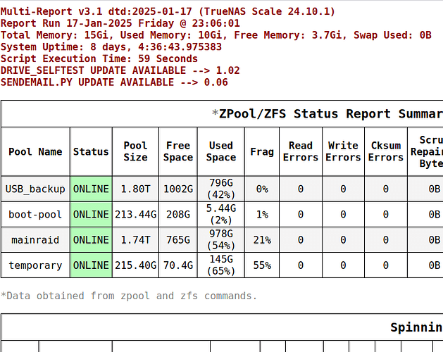

Hi @joeschmuck , I just updated to v3.1. Update seems to have worked okay.
At the top of the report it does say there’s an update available for sendemail. How do I update this?

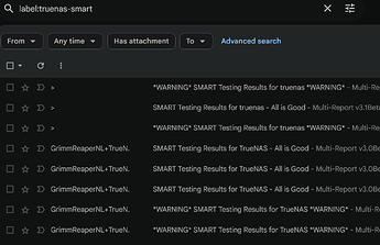

Also, my ‘sender’ information of the email is a ‘>’ with nothing else. Where do I fix that?
Thanks for the hard work.
I changed the way updates are done. You should not see those updates again unless a file needs to be updated. The script will automatically update if the file it is looking for does not exist. I will hopefully fix this in the next change.

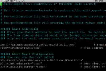

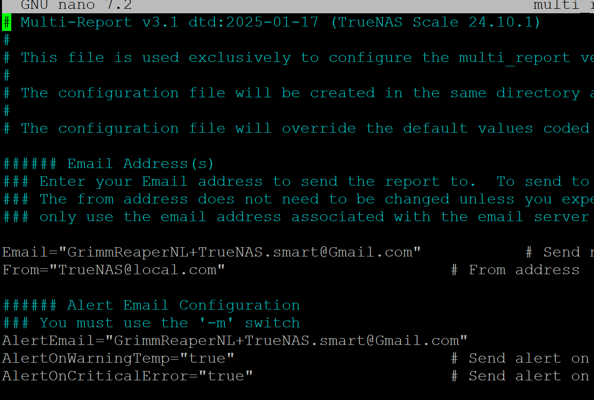

Now the next question will be about SMART testing. By default it is disabled, just in case someone has tests scheduled via TrueNAS GUI. You can change this using either -config or just open the file multi_report_config.txt and scroll to the bottom. You will see Short and Long test sections. Examine the text, I tried to make it clear. Change the test Mode from “3” which means no testing, to “2” to test everytime the script is run, which should be daily. Test Mode “1” has a different effect. Read about it in the Drive Selftest User Guide which should be in your script folder. That is actually important.

I do not understand. You have my email, can you grab a screen shot?
@GrimmReaperNL can i ask you how do you config your email on TN? Hide sensitive data!
Just for understand if Is something i can fix!

Before 24.10.1 updates it would look like this:
This is my multi_report config:
