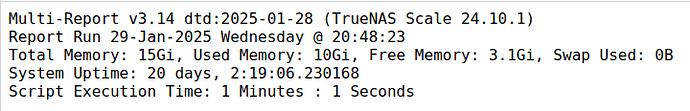

That’s odd. Even after updating to the latest version of multi_report, mine doesn’t show the version number of drive_selftest.
root@truenas[/mnt/TrueNAS/scripts/multi_report]# ./multi_report.sh
Multi-Report v3.14 dtd:2025-01-28 (TrueNAS Scale 24.10.1)
Checking for Updates
   1. Multi-Report - Installed:  3.14, GitHub:  3.14 - No Update
   2. Drive_Selftest - Installed: , GitHub: 1.03 - No Update
   3. Sendemail - Installed: 0.14, GitHub: 0.14 - No Update

That is odd. I thought I fixed it in v3.14. If it is not installed, it should say “Not Installed”, if it is installed, it should tell you the version. Since it says “No Update”, I have to assume 1.03 is installed. Please let me know what you find out.
So I just check in the script file and it says it was version 1. :sweat_smile:
Just ran -update_all and it allowed me to download the latest version of selftest.
Running the report now shows the version number. My bad.
Weird I never got a notice while running multi_report there was a new version for drive_selftest, or that it didn’t download an update.
