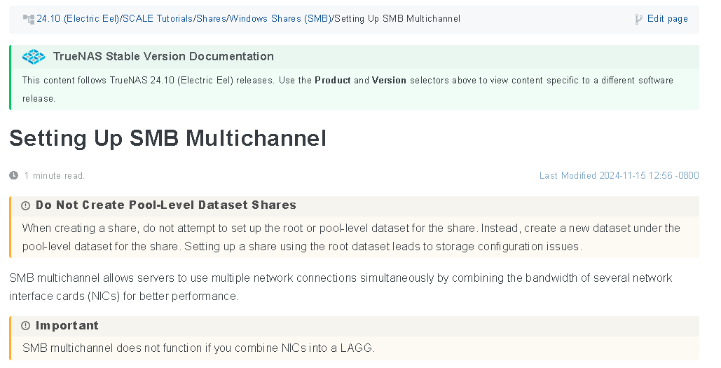

Docs say no LAGG.
" SMB multichannel does not function if you combine NICs into a LAGG."
Yes, that’s right. But i just wanted to know whether it also requires the support on the switch side as well :slight_smile:
Can you point me to the doc link please?
