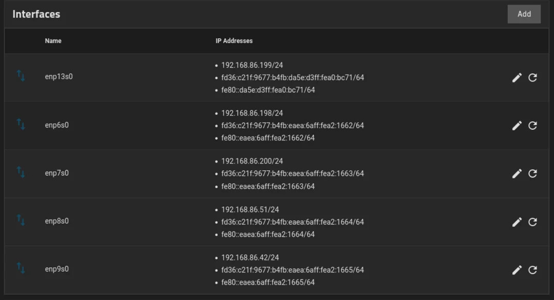

This is my current network config post truenas install

Original post updated with screenshot of my network config post the truenas install and the link to the scal LAG setup docs.

In the screenshot it looks like you put all 5 NICs in the same subnet, which is what arwen pointed out one should not do.

Oh I didn’t do that, That is how TrueNAS itself configured the networking post the installation of the OS. I’ve been trying to wrap my head around how to configure the networking so I’ve just not made any permanent changes yet.
