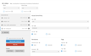

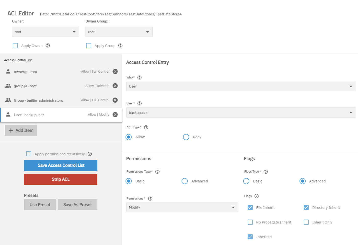

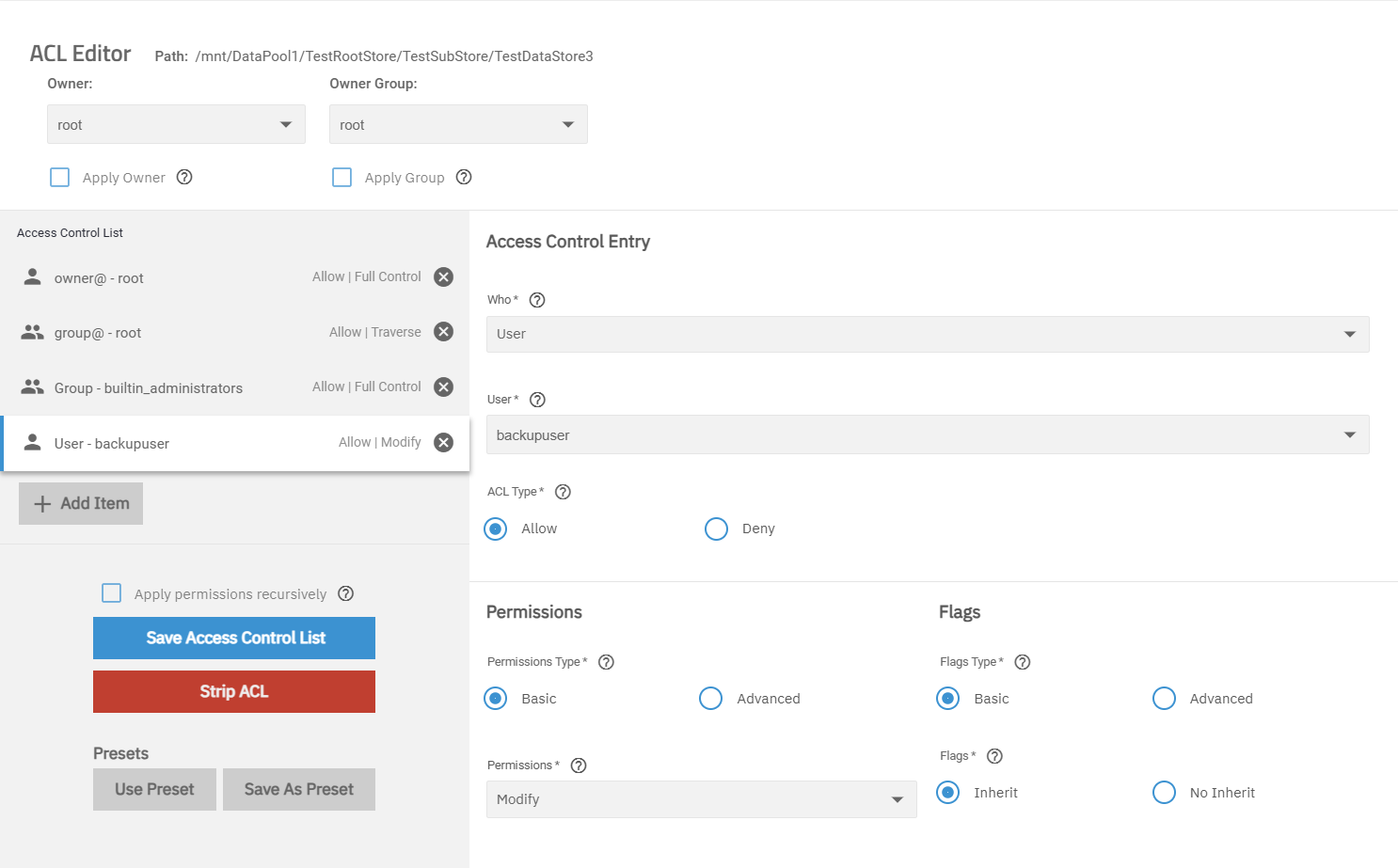

Can you share screenshots of your permissions for each dataset please.
If by exported you mean created NFS shares then yes for both datasets.
Here you go…
The ‘parent’ dataset (which backupuser can access):
The ‘child’ dataset (for which user backupuser gets access denied)
