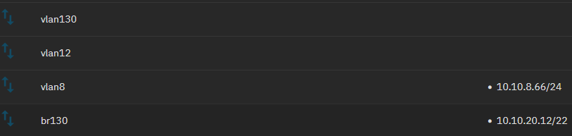

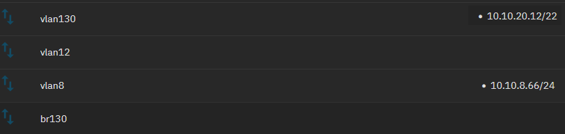

Is there any reason not to put an IP on a VLAN Interface if a BRIDGE is connected to that?
I’m losing connection to the GUI after a short while if I do so.
Working
Failing after a short while

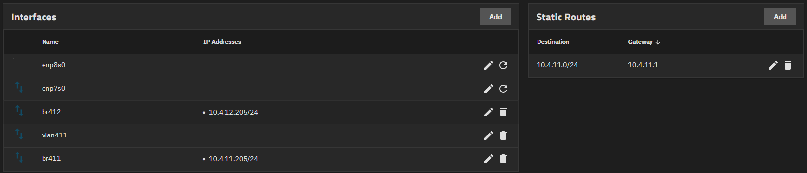

How can I map an extra NICs MAC, IP to the network interface in the TN GUI, which shows up in TN GUI Network, unlike the auto-configured bridge?
Hi @PackElend, I have a similar configuration you had, but maybe my backend network is configured differently, but I don’t assign IPs to VLAN, but assign them to the Bridge instead, then I have a static route for the separate VLAN.
what different does ot make?
I assigned IP to VLAN-NICs only when there is not a Bridge in the VLAN.
As soon as a Bridge is involved I assigned the IP to the bridge (otherewise that GUI is not reachable anymore)
By the way, why to you need Static Routes as it works without them on my side.

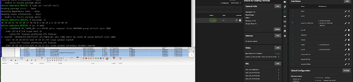

debian-admin@vm-DEBIAN:~$ ip link show
1: lo: <LOOPBACK,UP,LOWER_UP> mtu 65536 qdisc noqueue state UNKNOWN mode DEFAULT group default qlen 1000
    link/loopback 00:00:00:00:00:00 brd 00:00:00:00:00:00
9: eth1: <BROADCAST,MULTICAST,DYNAMIC,UP,LOWER_UP> mtu 1500 qdisc mq state UP mode DEFAULT group default qlen 1000
    link/ether 00:16:3e:55
debian-admin@vm-DEBIAN:~$ routel
Dst             Gateway         Prefsrc         Protocol Scope   Dev              Table
default         10.10.8.1                                        eth1
10.10.8.0/24                    10.10.8.3       kernel   link    eth1
10.10.8.1                                                link    eth1
10.10.8.3                       10.10.8.3       kernel   host    eth1             local
10.10.8.255                     10.10.8.3       kernel   link    eth1             local
127.0.0.0/8                     127.0.0.1       kernel   host    lo               local
127.0.0.1                       127.0.0.1       kernel   host    lo               local
127.255.255.255                 127.0.0.1       kernel   link    lo               local
debian-admin@vm-DEBIAN:~$ traceroute google.com
traceroute to google.com (142.250.203.110), 30 hops max, 60 byte packets
 1  10.10.8.1 (10.10.8.1)  0.349 ms  0.329 ms  0.275 ms
 2  3.80.254.84.ftth.as8758.net (84.254.80.3)  1.884 ms  2.235 ms  2.564 ms
 3  gwen.glb.as8758.net (212.25.27.124)  1.556 ms  1.894 ms grace.glb.as8758.net (212.25.27.126)  1.919 ms
 4  212.25.28.50 (212.25.28.50)  0.925 ms  0.891 ms  0.821 ms
 5  glyn.glb.as8758.net (212.25.27.247)  0.903 ms glyn.glb.as8758.net (212.25.27.245)  0.947 ms glyn.glb.as8758.net (212.25.27.247)  0.882 ms
 6  83.150.38.119 (83.150.38.119)  1.121 ms  1.185 ms 72.14.198.50 (72.14.198.50)  1.214 ms
 7  142.251.53.177 (142.251.53.177)  2.524 ms 142.251.245.151 (142.251.245.151)  1.099 ms 142.251.53.177 (142.251.53.177)  2.376 ms
 8  192.178.254.76 (192.178.254.76)  1.524 ms 216.239.41.42 (216.239.41.42)  1.680 ms 142.251.70.185 (142.251.70.185)  0.930 ms
 9  zrh04s16-in-f14.1e100.net (142.250.203.110)  1.484 ms 192.178.109.54 (192.178.109.54)  1.746 ms zrh04s16-in-f14.1e100.net (142.250.203.110)  0.811 ms
what leaves me still clueless is that I still can reach the VM via VNC and the TN host IP altough the don’t share a NIC.
