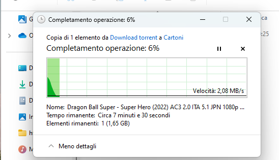

Sorry i’m new in this world and I don’t know how to do a iperf test but I tried connecting the server with an ethernet cable and now the speed has increased to from 3 to 8mb/s. I connected the 3 drivers in raidz1 because doing some research it seemed the most similar to a raid5 and I ad some ram now I have 9 Gib.
immagine_2024-06-15_122147193
This is the file I was uploading to test the speed and it is a single package of about 1.5Gib.
