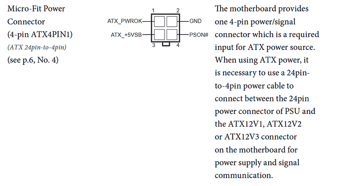

This is what the manual says
Mmh, the manual says something about a 24pin to 4pin power cable to connect to …ATX12V1, ATX12V2 or ATX12V connector? And a connection to the Micro-Fit Power connecter, I guess?
@prez02 I saw this photo where there is a “usual” 24 pin connector, I guess it is already included in the box right?
https://www.servethehome.com/asrock-rack-sienad8ud3-32x-sata-amd-epyc-siena-matx-motherboard-review/
Otherwise I need to buy another power supply right? If yes, what type of PSU is usually needed on server boards?
Only AsRockRack could tell how many of these connectors have to be plugged, especially if using a relatively low power part . But it looks like power is mostly supplied through these rather than the small 4-pin adaptor to the ATX connector.
A 1200-1600 W PSU may come with 3 CPU power connectors. Or you might order additional cables from the PSU manufacturer if the PSU is modular.
Note that if you do want 32 drives you’re going to need more than a mere 850 W. And then you’d want a real storage chassis rather than this Silverstone thing.
