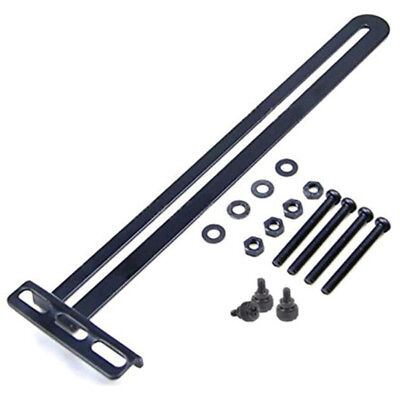

for the heat issue get
they’re available everywhere and put either a 80mm or 120mm farm on
40 mm fan 5 cfm
120mm fan 100 cfm
