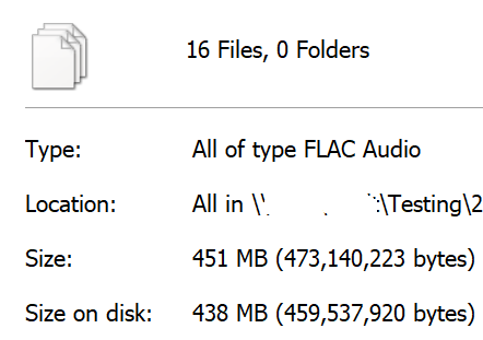

  2. Space savings are much more important than speed. Ironically, both datasets are set to zstd-19 and use 1MiB Record sizes, the Origin Dataset gets better compression and faster writes.
  3. See below images:
    OriginDSMP4
    OriginDSFLAC
    OriginDSMKV
Data written to the new DS is either larger than the original or no where close compression wise:
DestDSMP4
DestDSFLAC
DestDSMKV

That is helpful. The above images better illustrate my issue.
I am aware and this is intended. I am mentioning this because the CPU legwork is being done the the fruits of those cycles are not being written to disk.
How would one force compression to occur? In previous versions of True NAS (Pre Scale - as far as I can recall), this was as simple as configuring the pool\dataset option from the webGUI.
I am fine with the increased utilization – My issue is that files that I would like be compressed are taking more space on the new pool than they were on the original.
Indeed. Typical Z2 vs. Z1 (Z3 would be even worse). WIth these poorly compressible files, padding actually tilts you the wrong way…
Compression IS taking place, but it’s inefficient here (except maybe on some large office documents or executables). If you have a conveniently small sample dataset to test (or just enough space), replicate it to a new dataset with no compression (untick the box for full file system replication, which would override the destination settings) and compare again.
