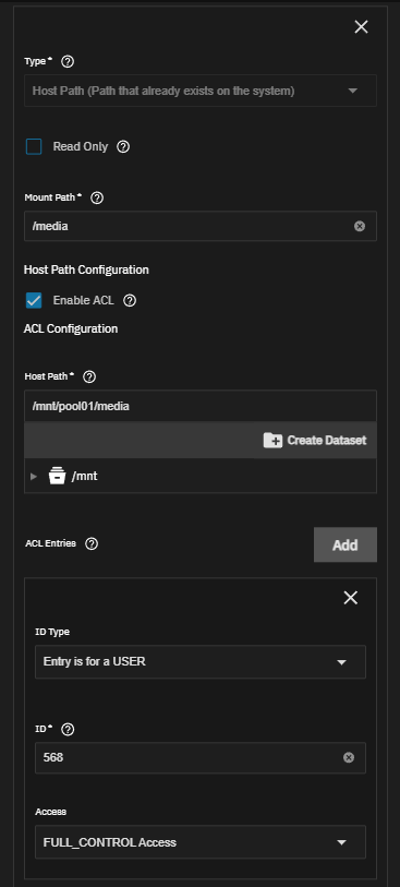

The permission issue is handled by the fact that the PleX user runs as user “578” (apps) by deafult, and I have given “apps” user FULL_CONTROL access to the media path.
I agree, if not for that, no files would show up. And yes, those that are there play fine. I’m trying to do this whole install without messing about with “chmod” because that’s just not scalable. ACLs are meant to handle all of this.

I had not added this entire folder/directory (00-Handbrake) to the mapping. I obviously have duplicate files (probably higher resolution than my (decade-ago) rip of my entire DVD collection. I have a different directory for higher resolution files, hence movies like Angel Heart showed up, but not Angela’s Ashes or Antz.
I am so sorry for wasting your time @Jorsher…
