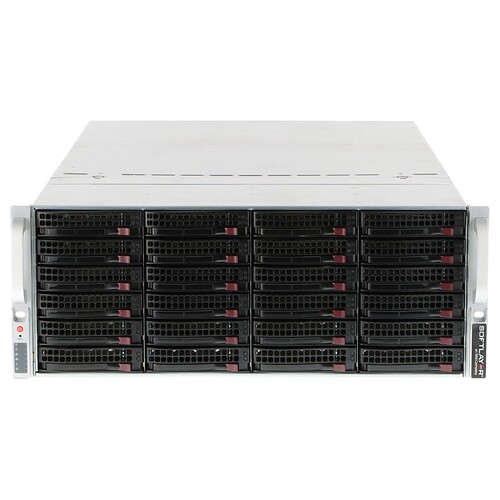

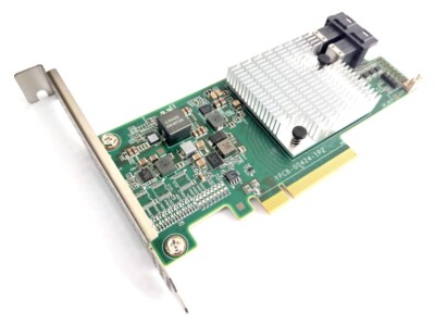

is this a good fit. dose everything fit togheter and all the hot swaps will work with the items below?
Chassie
https://www.aliexpress.com/item/1005004711190344.html?spm=a2g
jbod card
https://www.aliexpress.com/item/1005008545302112.html?spm=a2g

and for cpu and motherboard and memmory maby you have som recomendations. dose not have to be super stuff becuse its just gonna be my storage server and media storage. meby some game streming

Did you realize that the chassis you selected will be very loud from the screaming fans ?

the chassie i will replace the fans with noctua fans and the power supply will be an noctua aswell.

This is a complete system ready to run, with 4 CPUs and RAM. You only have to add disks. And you need to swap the RAID controller with an HBA.

Remember the HBA requires significant airflow to remain cool.

Oh, it’s quite a lot of capability for the price (and yes, your conversion is correct). But a four-socket, 64-core, 256 GB system as a NAS? Those Xeons burn a lot of watts…
I’ve got a slightly different system here from the same vendor at work as backup server. 4U, 36 LFF disks, two 2.5" boot drives, dual Xeons, 256Gb RAM, about 1200€ with rails. 32 of the 36 bays used… Very happy with that machine.
