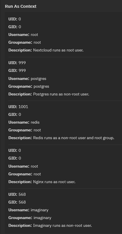

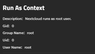

Just looking at the Nextcloud Apps page it says that Nextcloud should run as root though, and that’s the owner of the render device.
