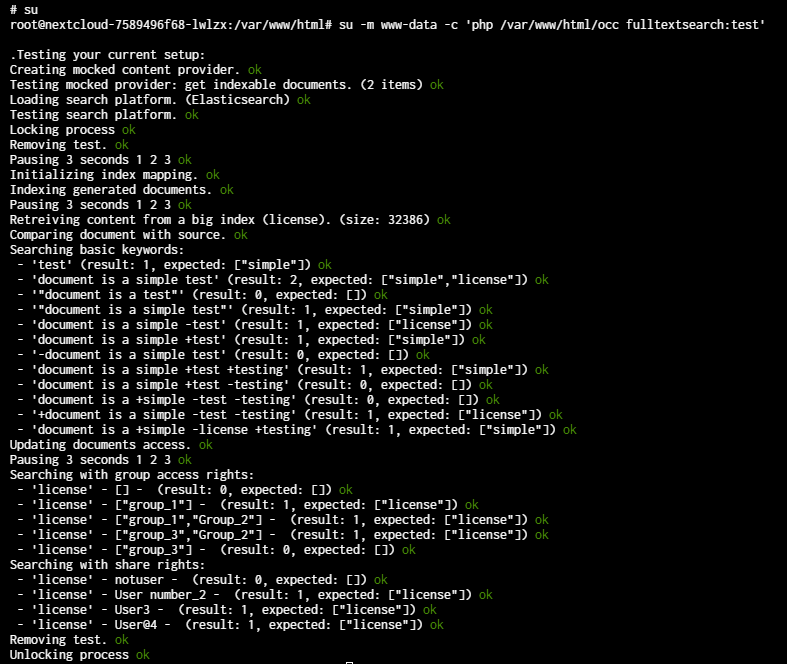

I’ve come as far as having this output when testing:
But no files show up in NC when searching (except the names being searched).

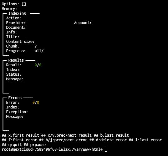

When I use su -m www-data -c 'php /var/www/html/occ fulltextsearch:index', this is the result:
I have also executed su -m www-data -c 'php /var/www/html/occ db:add-missing-indices' but no results have changed.
