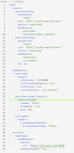

I transposed my old Traefik config of Nextcloud (which I was hosting on Docker on my previous setup) into this config.yml :

Also, I am sharing with you my Traefik config.yml.

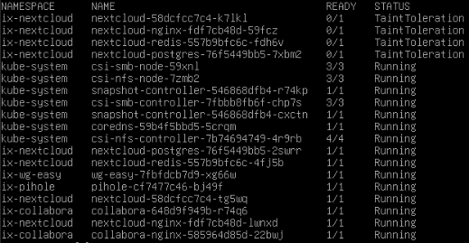

Can you run the following command on your Truenas Shell to know if it’s running or not?
k3s kubectl get pods -A

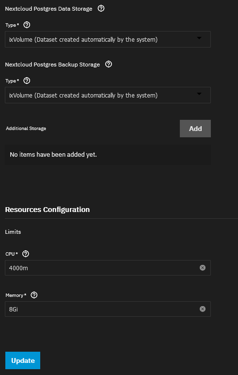

I detailed here my Nextcloud installation’s details. I have set two environment variable. “Overwrite Host” is pretty much the same as the “Host” field in the config, it’s the URL that is set everytime I click a link within nextcloud.
If this variable is set to “cloud.redacted”, then let’s say I log in with 192.168.1.233, if I click a link to “login” it will send me to “cloud.redactedlogin”

Have you tried now with my config.yml for Traefik?
Also, could you send some screenshots of your Nextcloud App configurations?
yes, with both yours and mine, same results
all other informations are on my original post
