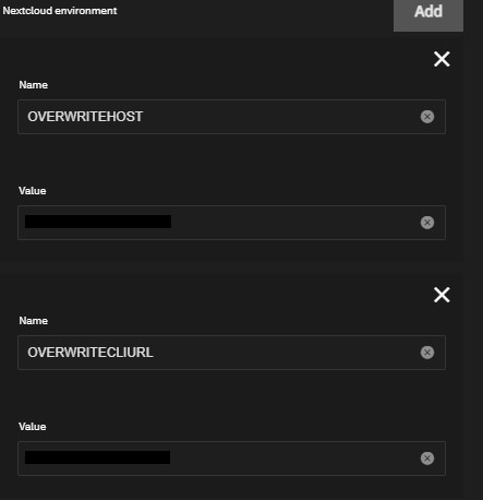

Hi all i recently upgraded my truenas system to 24.10 and my nextcloud app didn’t migrate so went through the process of re-installing the app. However, when I try to access the nextcloud instance using my domain (for example we will use my.domain.com) it re-directs it to the internal IP address. This only happens when I set the host option to the IP of my truenas server. When I set the host to my.domain.com it does not load. if I leave it blank like how I had configured the app before upgrading the system to 24.10 I get a Access through untrusted domain message.

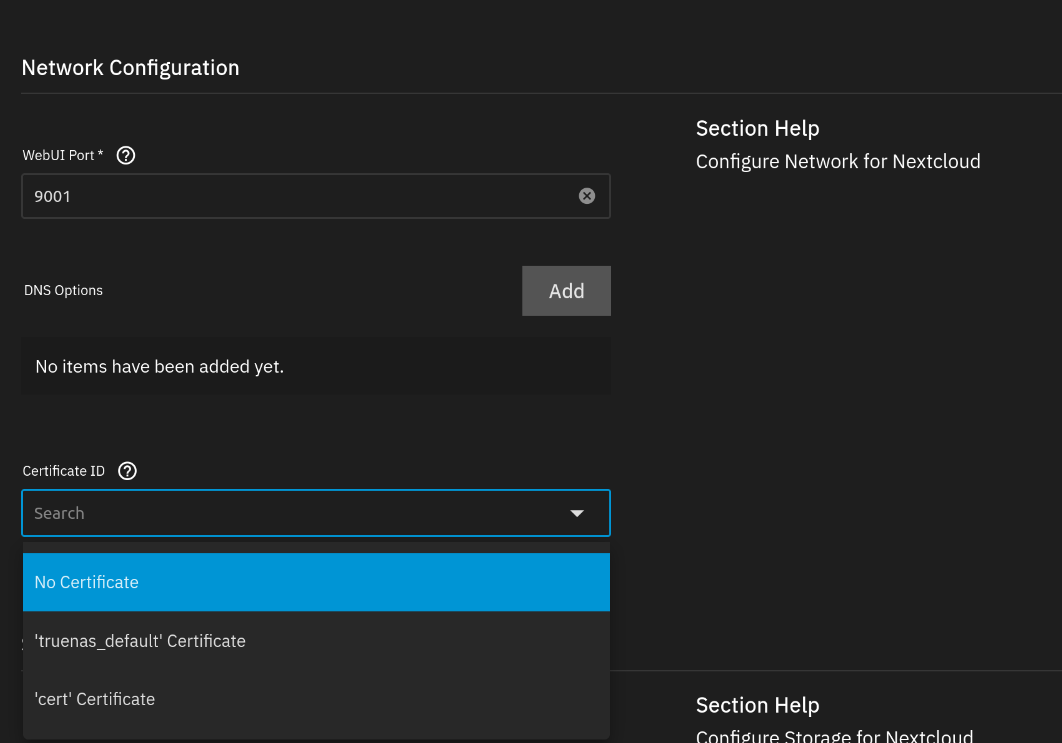

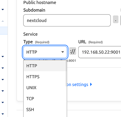

I fixed it by switching cloudflare tunnel to http and removing certificate in truenas nextcloud config

No, I kept the 24.10. version, removed certificate on truenas nextcloud install. And then switched cloudflare tunnel to http local address.

Thank you. Did you add any additional environmental variables, or did you just use the ones I included in the post? Also, did you have to add anything for host in the next cloud app settings?
@S1ngl3 did you have to add any environmental variables or have the host filled in?
I edited the config.php file manually so no env variables. And yes, I specified allowed domains and so on.
However, what really helped me solve the issue was just starting all over. Try to access nextcloud locally without https, then add a tunnel and then add config file changes if needed.

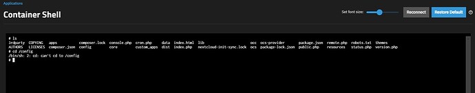

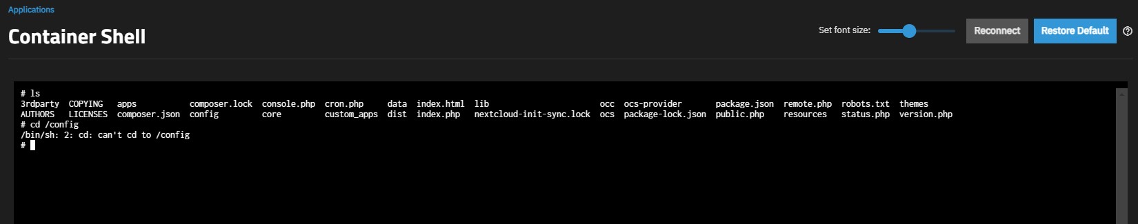

@S1ngl3 I am very new to truenas, is there a specific way to get into the config.php file. Ive ssh into my truenas and also used the shell built into truenas scale and used the ls command but couldn’t see the config.php.

doing a LS shows these:
I think there is no “magic bean” shortcut. Study containers, volumes, datasets, datasets mounting.
Then it’ll be easy to access config.php .
But long story short - find in which dataset your nextcloud mounts are located at and then mount them. I think the most straight forward way is to just use the Apps page and then click on Nextcloud → Shell → and then find the config,php file (the ssh shell is /sh shell inside container
And you don’t need to create a file, it was there all along.

@S1ngl3 thank you for your help. i have just figured out how to get into the file :slight_smile:

access it through the “Apps” page, not through ssh, it’s simpler that way
but error “permissions denied” is again error which tells you to “go back and understand how linux works”. Sorry to be “that guy” but it just takes time. That’s why it’s paid so well.
