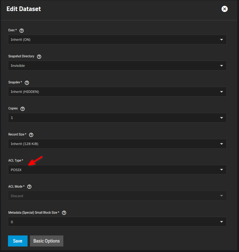

SOLVED!!!
Hi all! ![]()
I am happy to have solved the problem and share the solution in case someone else has the same need.
I had read Truenas Scale has a different management of some filesystem options, such as the ACL.
First of all I upgraded the Truenas from CORE to SCALE, with precision from Core 13.0-U6.7 to Scale 24.10.2.
To upgrade I had to export the conf from the Core, install SCALE and reimport the conf.
After that I changed the options of the nfs dataset as in the screen below, enabled POSIX acl.
Restarted nfs service on Truenas, remount path in server.

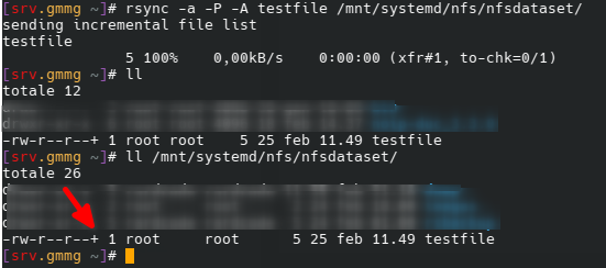

Launched rsync with a test file:
rsync -a -P -A testfile /mnt/systemd/nfs/nfsdataset/
Result:
ACL correctly reported!! ![]()
Thank you all for your help!
