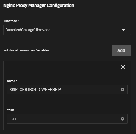

After installing 1.2.6, try the following:
GENIUS! That did it, now I just have to reconfigure all my proxy hosts :frowning:

I was waiting to see if another ‘fixed’ version came out, nothing. Until I saw your post and that did the trick! I have not yet finished configuring NPM, it is running and I have Let’s Encrypt working again. Next I will check to see if I can just copy over the host configs or build them all out again.

Thanks! This did it for me.
I just installed Nginx Proxy Manager for the first time in the last couple weeks and it’s persistently failed to deploy. This fixed my issue. Thanks!

I was stuck at
  • /opt/certbot/lib/python3.11/site-packages
but add the environment variable that you mentioned made it started, thank you a lot.
I had been slamming my head into my desk for a few hours, I created this account just to thank you!!!
