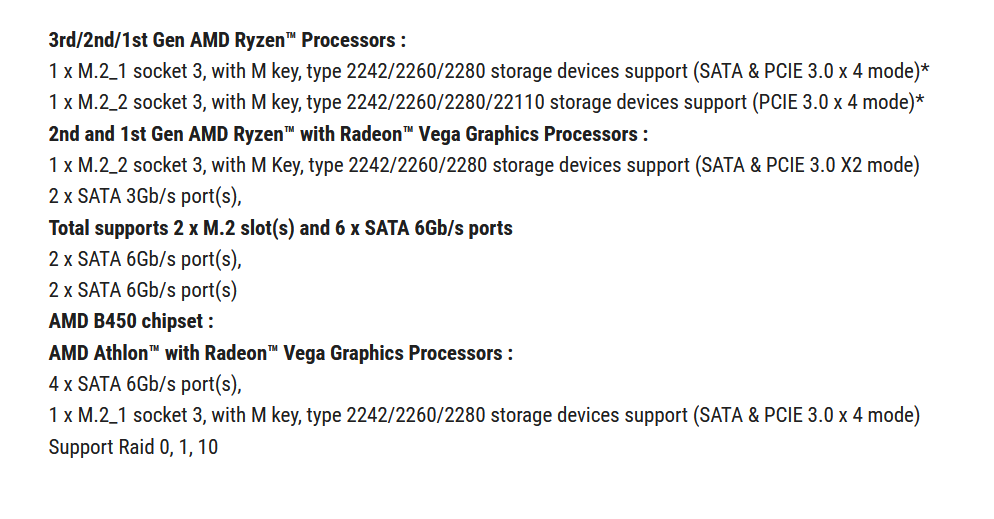

As I recall, some motherboards do weird stuff between allowing more SATA ports to be active vs. PCIe lanes and all that has to be set in the BIOS also. I’d sit down with the manual to this motherboard and have a deep read of available info.

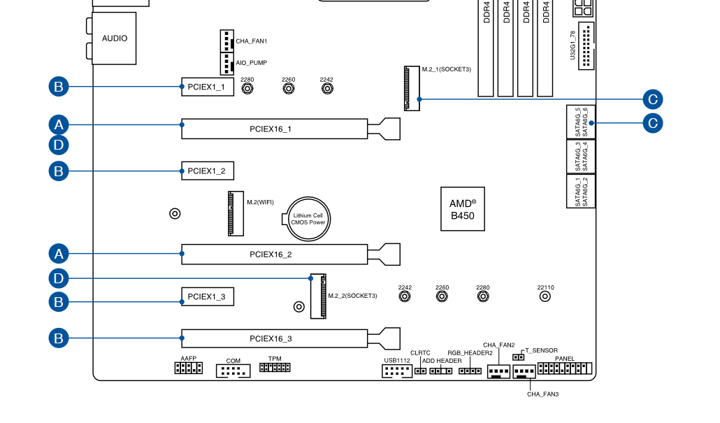

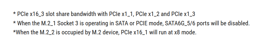

There is a image in the manual showing the shared connectors.
The SATA M.2 has to be in the port labelled C, is the SATA drive by any chance connected to the two SATA ports labelled C also?
No it is in sata1
Almost a pity, I suspect it would have still been able to boot, just not find the drive connected to the SATA Port 5/6.
