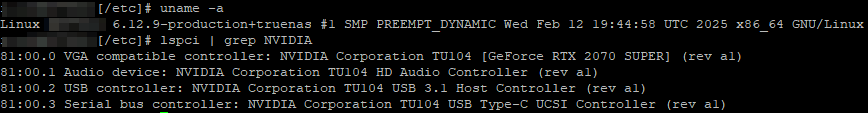

I’m experiencing what seems to be the same issue on 25.04 despite not running the debug kernel. I’ve even enabled the debug kernel & rebooted, tested, disabled it again, and re-tested with no change in behaviour. No luck with a 1080ti or a 2070 super.
Despite trying all of the fixes I’ve found on this forum, nvidia-smi will not communicate with the NVIDIA driver. lspci shows Kernel modules: nouveau, nvidia_drm, nvidia.
The GPU is listed as available for isolation, but cannot be chosen in any Apps.
Hey @shindo
Can you post the results of uname -a as well as the full lspci output with regards to your card?
Sure, here you go:
Thanks for responding!
