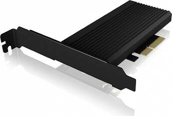

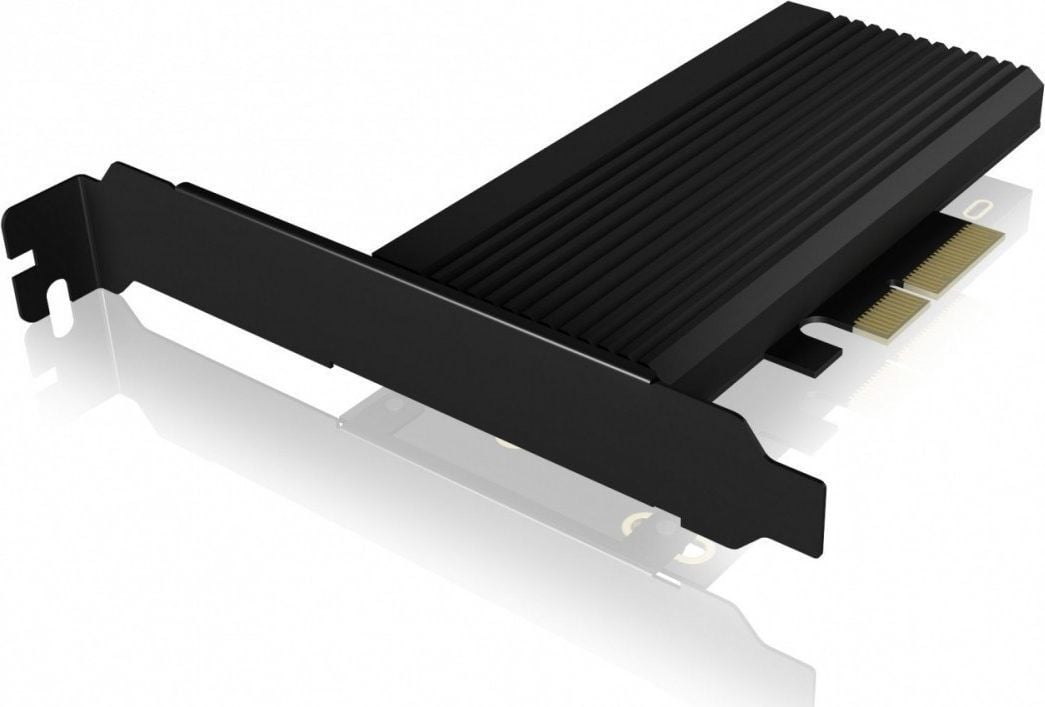

Buy a few m.2 heatsinks. The slim ones are easier to fit if your drives are near other components, such as a GPU, CPU, or RAM. The thicker ones will keep your temps lower and do better at spreading heat.
I only ever use heatsinks with my NVMe drives, and I recommend everyone do the same, if their chassis has enough room.
You don’t need the ones that have small fans. A passive heatsink works just fine, especially if you have proper airflow in the case.
