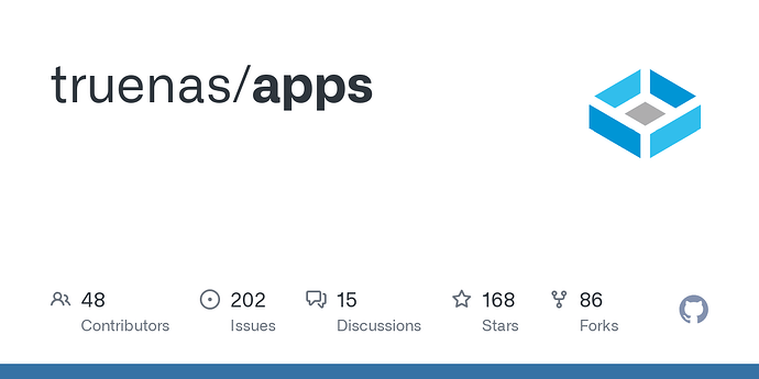

@honeybadger Can this be a feature request for the TrueNAS catalog to update their ollama image to include ipex-llm?
@Rocketplanner83 My only ARC card at the moment is a B-series so I unfortunately can’t poke at this as much as I’d like first-hand, due to xe driver issues.
Submitting an issue to request the feature on the Apps github directly is probably the way to do it, although let me see if I can find anyone internally with an A-series card.

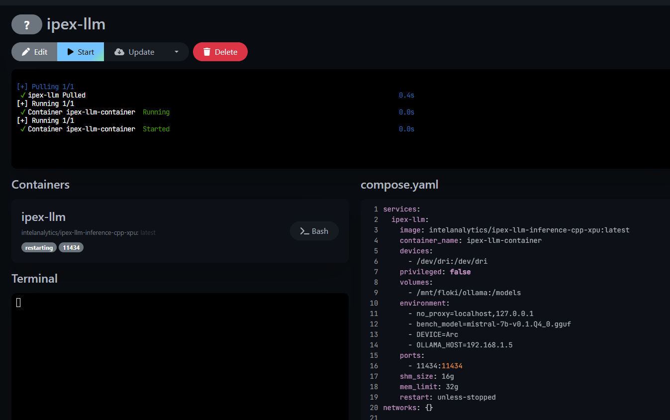

I am trying with a custom app in dockage and first attempt is giving me an error.
> services:
>   ipex-llm:
>     image: intelanalytics/ipex-llm-inference-cpp-xpu:latest
>     container_name: ipex-llm-container
>     devices:
>       - /dev/dri:/dev/dri # Map GPU devices
>     privileged: false
>     volumes:
>       - /mnt/floki/ollama:/models # Mount your models directory
>     environment:
>       - no_proxy=localhost,127.0.0.1
>       - bench_model=mistral-7b-v0.1.Q4_0.gguf # Example model, adjust as needed
>       - DEVICE=Arc # Or iGPU, Flex, Max
>       - OLLAMA_HOST=0.0.0.0 # Allow remote connections to Ollama
>     ports:
>       - 11434:11434 #Expose Ollama port if needed
>     shm_size: 16g #Shared memory size
>     mem_limit: 32g # Memory limit
> networks: {}
the error in dockge was “ipex-llm-container exited with code 0”
here is the link to the github page

I was doing it in dockge where do I find more detailed logs?
Sometimes I feel like the only one with access to documentation, search engines, and LLMs :slight_smile:
Try this?
docker logs ipex-llm-container
lol I should try that more :slight_smile:

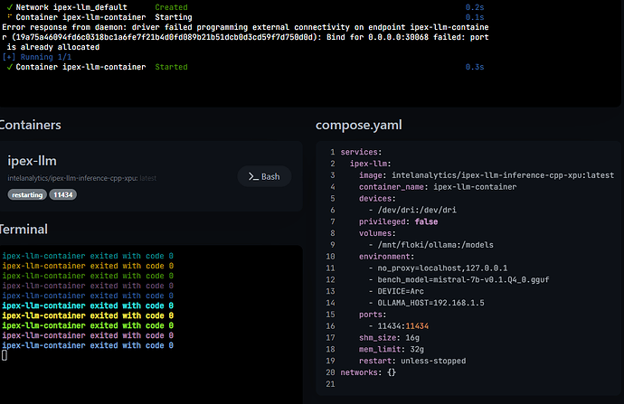

I am not getting any logs when I try that. the container is showing this in dockge.
The problem is in your screenshot…
The port is already allocated to something.
If you have another ollama container, perhaps the one you were trying to use at the start of this thread, stop the container so the port is free…
you were right I fixed the port issue but still having no luck.
Logs?
Im not getting any when I run the logs comand
