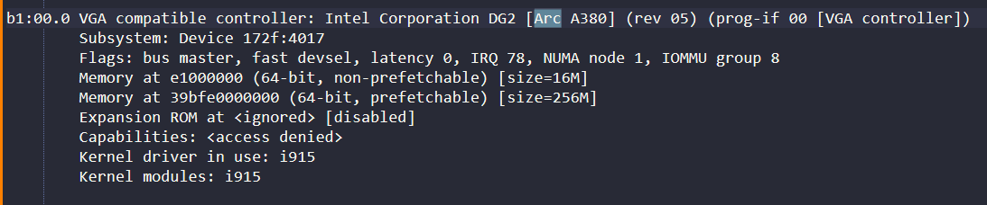

I’ve been trying to get a Debian 12.5 VM up and running to run as a docker host. My Intel Arc A380 is being isolated in the advanced settings just fine. I was getting errors initially but after a reboot without it in my system, it allowed me to isolate the device.
When I pass the device to the VM, TrueNAS OS crashes. It appears as though it’s trying to use the display device for some reason. I’ve attempted to “Ensure Display Device”, not “Ensure Display Device”. Create with and without the pci device attached and adding later. I’ve tried swapping pcie ports to forward.
I know the GPU is functional as I’ve setup a workaround Jellyfin server in the TrueNAS Scale Applications, but I don’t want this to be a long term solution as the apps are being deprecated and I have no idea what the GPU support with look like in Eel.
Has anyone experienced this issue or can anyone offer any advice?
My system is a Dell T440 with the latest drivers and firmware for BIOS, etc.
TrueNAS version Dragonfish-24.04.1.1. If I boot the VM without the pci passthrough device the VM functions as normal.
There is nothing else in the IOMMU group it’s in. There is a Matrox embedded graphics in the Dell system.
