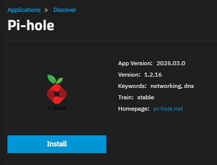

The version control # moreover is not helpful either since it gives no clue as to which version of Pihole it’s pointing to. Am I just going full dotard or is there a guide how to deal with the latest SCALE Pihole app?

There’s not an updated Pihole guide in our docs, but you might get some use out of the general apps information in TrueNAS Apps | TrueNAS Documentation Hub might be somewhat helpful, for example: https://www.truenas.com/docs/truenasapps/#understanding-versions.
The short answer though is you need to go back to the info screen.
Version is the TN catalog version, App Version is the upstream Pi-hole version.

Moreover please understand my confusion re: the App version. The offificial github web page currently lists 6.05 whereas the App seems to be referencing a date stamp.

Lastly, the App author is on version 2.014 for the App on his Github but iXsystems App is still pointing to 1.x, presumably because 1.x is stable and 2.014 is not?

As for the version numbers, there appears to be some cruft with the source links. The version 2025.03.0 refers to the docker-pi-hole version: Release 2025.03.0 · pi-hole/docker-pi-hole · GitHub
The link you’re referencing to charts/charts/pihole at master · truenas/charts · GitHub is the old Kubernetes version. The actual source is apps/trains/stable/pihole at master · truenas/apps · GitHub.

It is the link the App references in the GUI.

right, that’s what I was referring to as cruft :wink:
It was correct in 24.04, but is no longer.
