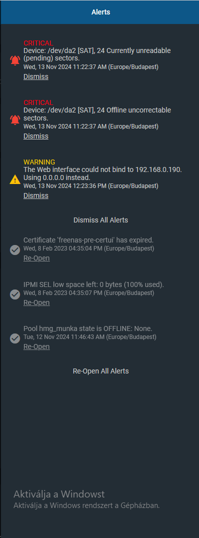

As I wrote above, it started when I had an error message for a long time and I noticed that instead of 8, I only see 7 disks. I wrote out the serial numbers from the Storage/disks menu. I thought that I would put the new hdd in the place of the one that is not listed and that’s it. Instead I saw “pool unknown”. Then I panic. I put back the hdds that I took out. Nothing. I tried it with a disc I had taken out a while ago (in case I was wrong). Nothing. I tried the scrub on the non-existent pool. Obviously nothing. Browsing the Internet, trying to import zpool. Then I got here in the evening after looking through the old freenas forums.
Now, however, I noticed that I get this error message when I put one of the hdd back. This hdd is the 3rd member of the damaged array. Can something be done with this? Is there at least some way to get it working until the resilver takes place with the new win

Da2 is growing some (irreparable) low level failures. That is bad.

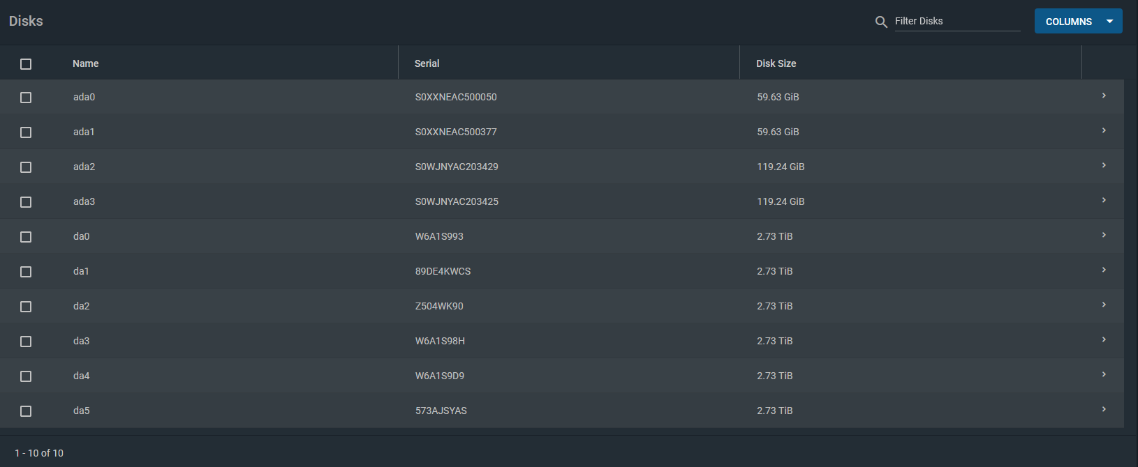

The bolded items are the serial numbers for the drives that are recognized. The missing two drives will be something else. I assume you know which drives you replaced however always track by serial number. I was hoping the midclt command would also provide the missing serial numbers but it did not.

As for the da2 error message, I can’t stress this enough, you need to convert the da2 into a serial number. You can do that by using smartclt -a /dev/da2 and then you will have the serial number of the drive, and it should match one of the drives you just installed. Remember what was said before, drive names (IDs) can change and they do, especially when you introduce a different drive.
When you added that drive and received those errors, did you see if the pool was back online? If not, could you import it? I say these things because you already know you have two drives that had errors so you should expect to see those. Also, 24 offline unrecoverable errors is not tragic. Your only goal here is to get the pool mounted and once it is, copy all your data off the machine to somewhere safe. Nothing more at this time.
If you have no place to copy the data then you need to “Replace” the drive using the proper procedure, with the failed drive still installed. You do not need to run a SCRUB, the checks will happen automatically while rebuilding the pool or reading the pool.

What is labeled da2 in this image is not the same drive as the one running as da2(s/n z1f4txdc) in the error message above. Only the original drivers are loaded now. of the two missing ones, you don’t see one at all, and the other is da2 in the error message.
That is why I had the question, whether the da2 drive in the error message can somehow be made online. Even using some external application.

I may not be understanding you; when you installed drive serial number z1f4txdc, it generated the error message of the 24 offline unrecoverable errors, correct? And if true, that is okay.
