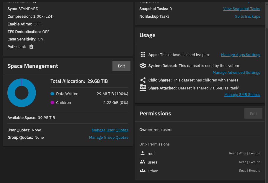

So I have a 6 x 16tb hdd pool, that I initially created in Omv, then imported into Truenas. Omv lacks all the sophisticated features of Truenas, such as properly creating datasets.
So I have 40tb in the root dataset of the pool, not the proper way, because there was no way to in Omv.
Because of this, I cannot change the Acl’s.

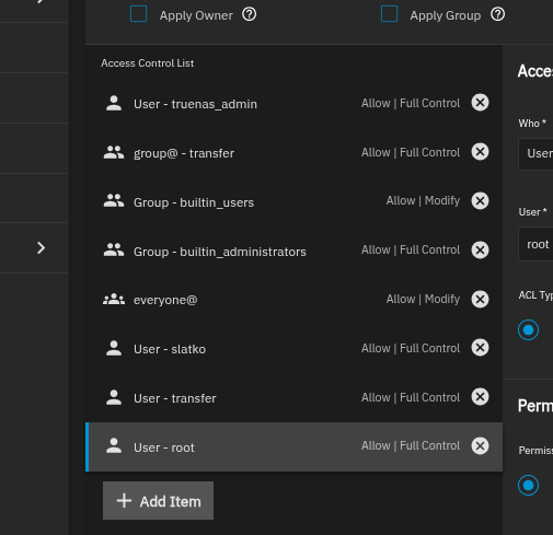

Just to get the files copied over here’s the acl’s of pool that gives the rsync errors.
Screenshot From 2025-12-23 11-47-47
If you can add /remove users and groups, add the “apps” user and group to the acl recursively.
Ah, an apps user instead of a Plex user.
This fixed it! Thanks!
