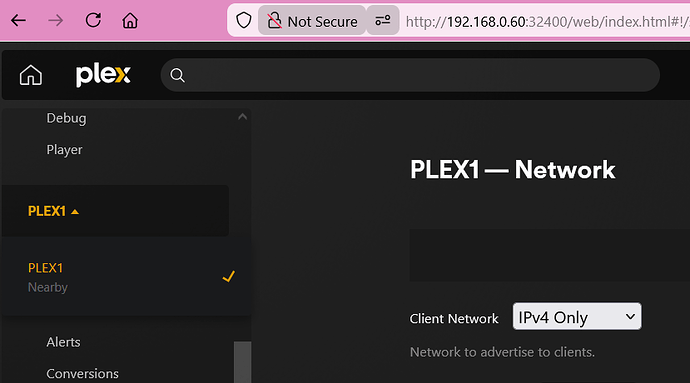

All I know is that when I have issues, the only common thing I can see is that it shows my connect as remote. Even when I’m connecting to my servers IP of 192.168.0.60 on port 32400 and go into the network section as you suggested it shows my connection as “nearby” in the left side where the server name is noted. When I use the DNS name it says remote.

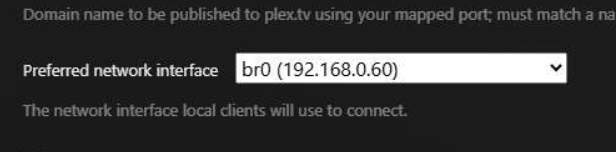

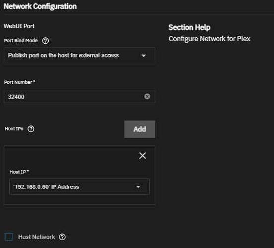

In the app settings under “Network Configuration”, if I select “Publish port on the host for external access”, enter the port number of 32400 and select the IP I want the app to use which is 192.168.0.60 and leave the “Host Network” option unchecked as shown in the pic below…

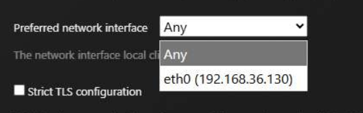

In the network settings for Plex it doesn’t show the 192.168.0.60 IP in the available selections for “Preferred network interface”, just the network for the container are shown. I would think defining the IP to use would allow Plex to see it however it seems this only sets up the mapping of the IP into the container.

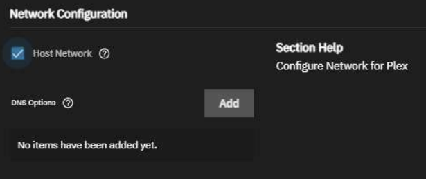

If however I select the “Host Network” option (which is recommended on the Plex forums to check despite the app config saying not to), the options to define the IP I’d like to use for the app go away.

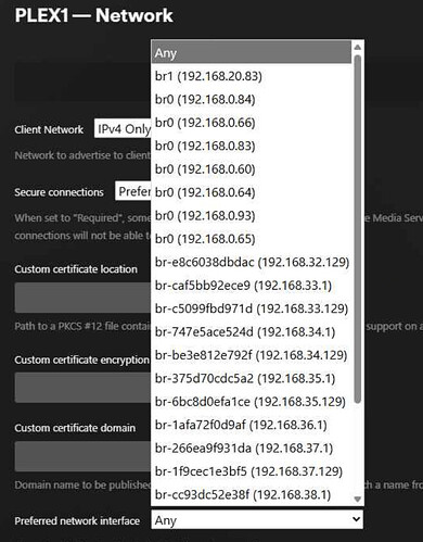

and all my configured network IPs show up in the Plex app to select as well as the IPs in use by my other containers.
If I select the one I want to have it use and click the save settings Plex then moves to one I didn’t select to use. I can only leave it on Any which I really don’t want to as it will use all the interfaces and advertise everywhere.

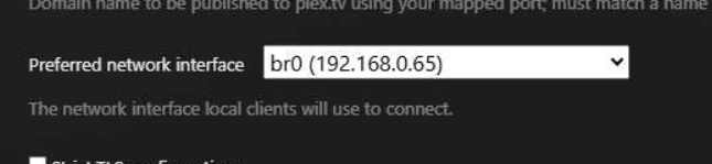

Selected 192.168.0.60 and hit save…
Plex changed it to 192.168.0.65…
