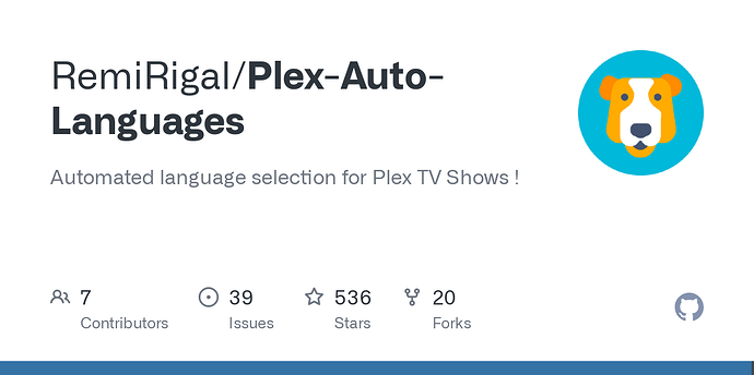

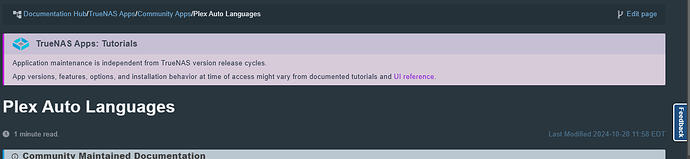

Additionally, the TrueNAS Community Apps page links to the wrong version:
The link provided goes to:
Automated language selection for Plex TV Shows !

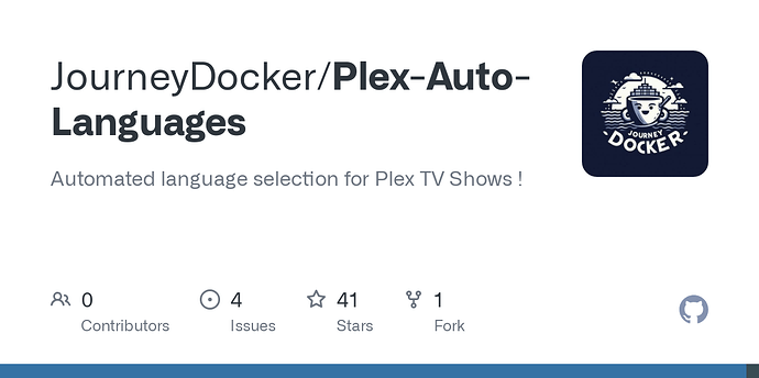

When the version available on the Community App store from the App GUI is:
DjP-iX
February 25, 2025, 9:14pm
Thanks @Maximilious . If you suspect a bug with the app in the TrueNAS catalog, you can submit an issue directly to truenas/apps .
And for the documentation issue, I’ll take care of updating that link, but for future reference you can either use the Edit Page link to propose changes yourself or click the Feedback button to submit a docs issue.
