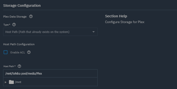

hello, im having a problem with plex.
i have migrated my server from core to scale (Dragonfish-24.04.2.5) and i wanted to install plex again. it fully installed it but it cant find my data on the smb share i use

If you browse /data from Plex, you should see everything at /mnt/toshiba pool/media/Plex…
i dont see anything in plex

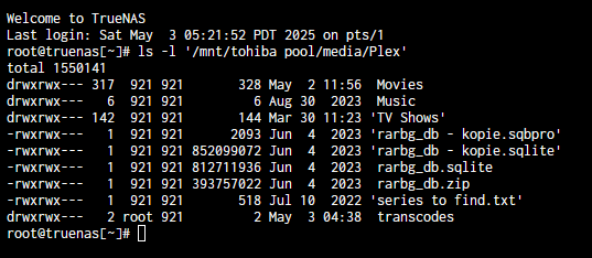

ls -l '/mnt/toshiba pool/media/Plex'
You have a space in the path so it needs quotes.
afbeelding
my directory doesnt seem to exist.
Sorry again, I had to zoom in.
i thought it said ‘toshiba pool’, not ‘tohiba pool’. Old man.
ls -l '/mnt/tohiba pool/media/Plex'
no problem. im dyslexic, i wrote it wrong when setting it up 3 years ago.

Try this in the shell?
chown -R apps:apps '/mnt/tohiba pool/media/Plex'
It will set apps:apps as the owner for everything in that path. ‘apps’ is the user that ‘Plex’ runs as.

thank you so much, that worked
If you look back at the output of ‘ls -l’ earlier, you will see ‘921 921’. This is the ‘user’ and ‘group’ that own those files. I think ‘921’ is the user id / group id of the ‘apps’ user on Core.
On Scale, the user ‘apps’ has user id and group id of 568, so didn’t have permissions to those files. The ‘chown -R’ recursively changed the owner of those files to the correct apps user (568).
Not the “apps” user, but specifically the “plex” user.
If you installed the “Plugin”, I believe it automatically creates the 921 “plex” user on the host to match the UID within the jail.
If you installed it manually in a jail, then you’d need to manually create user UID 921 on the host and name it “plex”.
