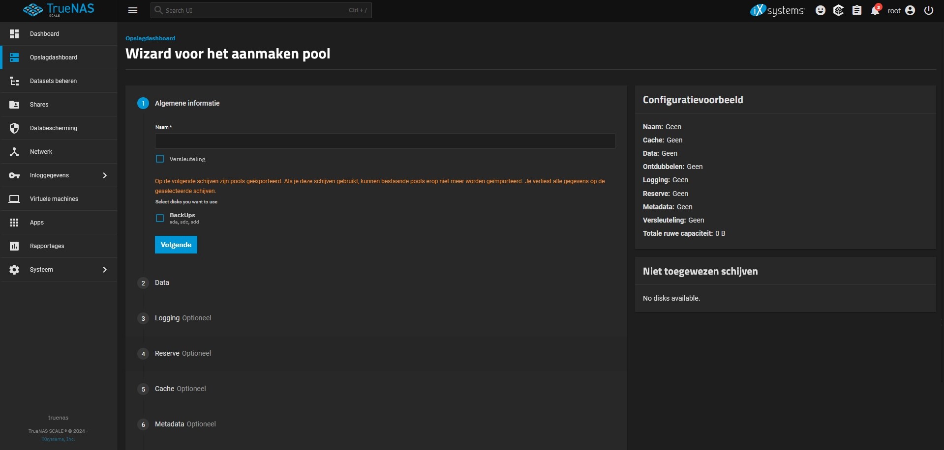

I run into the problem that when I want to add the exported pool it deletes all the date, see picture.

If your pool has been exported you need to IMPORT it to get it back without removing the data.
In your first picture the button is called Pool Importeren and is in the top right corner.
